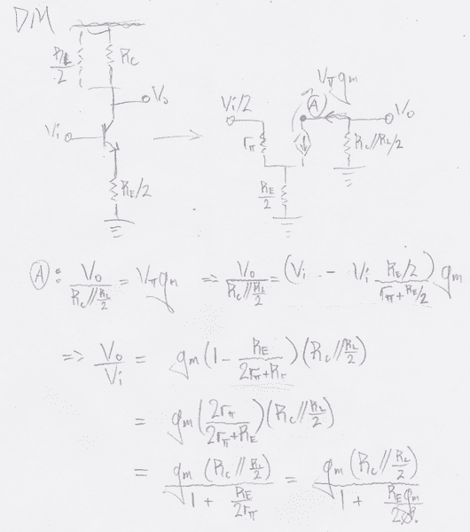

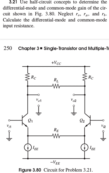

Hey all! I have been trying this problem for a while and can't seem to get the same answer as the solution. If someone can tell me where I am going wrong, that would be much appreciated. I am very close to the solution, but I am missing a term in the denominator. Everything is shown below! Thank you for your time.
Schematic of a BJT differential amplifier: two NPN transistors Q1 and Q2 with collectors tied to +VCC through RC and RL, emitters joined through RE and each fed by a current source IEE returning to -VEE, inputs vi1 and vi2, outputs vo1 and vo2.

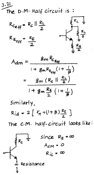

(the solution from the solution manual)[/B]
Handwritten derivation of a differential-mode half-circuit of a BJT differential amplifier, with formulas for Rc_eff, Re_eff, Adm, Rid and a common-mode half-circuit sketch.
Handwritten differential-mode analysis of a BJT differential amplifier: a half-circuit with RE/2 and RC//RC/2 and a derivation of Vo/Vi = gm(RC//RC/2) / (1 + RE/(2 rπ)), with the final denominator shown as 1 + RE gm/(2β).
I am getting stumped. Please help : /

Since the two halves are coupled both at the emitters and collectors I would not try to use the "1/2 d.m. model" at all. Write the usual equations, I would go with kvl (actually I just sum currents to zero at every dependent junction which is basically the same set of equations.)
If you HAVE to use the d.m model I cannot be of help.

Actually a pretty involved analysis. 7 equations, 7 unknowns.
For c.m. gain a hint: consider symmetry!

The main problem I see is that you have calculated the voltage across RE/2 using the voltage divider formula applied to the input voltage Vi. But the current into RE/2 isn't just the current flowing down through rπ; you also have to include the current flowing down from the dependent current source, so you can't just use the voltage divider formula.
