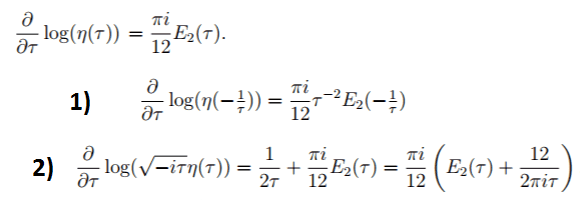

Use the top line to get 1) and 2)
above
So for 2) split the log up using ##log (AB)=log (A) + log (B) ## and this is simple enough
I think I may be doing something stupid with 1) though. I have
##\frac{\partial}{\partial \tau} log (\eta(\frac{-1}{\tau})) = \frac{\partial}{\partial \tau} log (\eta(\tau)) \frac{\partial}{\partial \tau}(\frac{-1}{\tau})= \frac{1}{\tau^2} \frac{ \pi i}{12} E_2(\tau)##
##(f(g(x)))^\prime = f^\prime(g(x))g^\prime(x)##
You applied the rule incorrectly,
##\displaystyle \frac{\partial}{\partial \tau} log (\eta(\frac{-1}{\tau})) = \frac{\partial}{\partial \tau} log (\eta(\color{red}{\frac{-1}{\tau}})) \frac{\partial}{\partial \tau}(\frac{-1}{\tau})= \frac{1}{\tau^2} \frac{ \pi i}{12} E_2(\color{red}{\frac{-1}{\tau}})##
