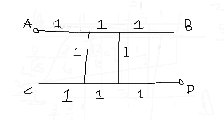

Calculate the total equivalent resistance between A and D -
( All resistors are 1 ohm )
The only thing I can see is that the two straight 1 ohm resistors are in parallel , giving 1*1/1+1= 1/2 resistance. But what next , please help !

It's not clear what you mean by "the two straight 1 ohm resistors", but try this...
Since B and C are open circuits for this question, delete their respective 1 Ohm resistors. Then re-draw the circuit, with A at the top and D at the bottom. See if you can draw the resistors in a more normal configuration, using this simplification...
There are no resistors directly in parallel so the above can't be right.
Do what berkeman said.

Okay.
After deleting those two , I can see two pairs of resistors in series giving 2 each. Then these two 2 ohm resistors are in parallel , giving 1 ohm. Now these is in series with the remaining two 1 ohm resistors giving 3 ohm as the answer. Am I correct ?
I am sure that you are correct.
I agree.
According to Wheatstone bridge
Answer is 7/4 ohms that is 1.75 ohms
Am I correct ?
Am I correct ?
No. Show your work. Or better yet, start a new thread since this is a rather old thread (from 2013) and the Original Poster hasn't been logged in since 2015.
