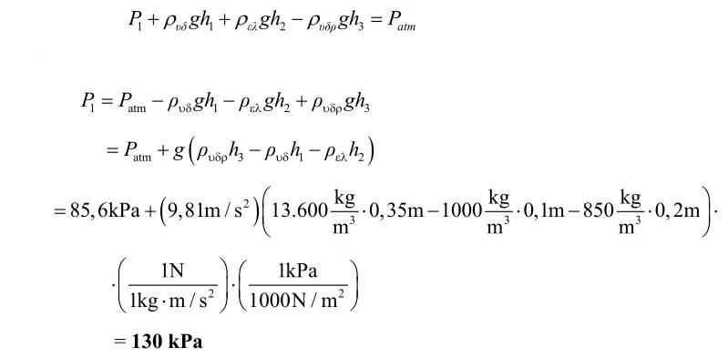

My question is simple. I can't understand how I define the direction of pressure in each "changing" point. I also have the solution if needed.
Okay, although another lecturer pointed out that pressure should be a vector, I shouldn't mention the word direction - you are right.
If I rephrase it to "how to find out if pressure is positive or negative"? Does it make sense now?
Here's the solution. I can't understand how I define where I put + and where I put -
υδ stand for water, ελ for oil and υδρ for mercury. ρ is density
Handwritten solution to a multi-liquid manometer problem: P1 + ρ(water)gh1 + ρ(oil)gh2 − ρ(mercury)gh3 = Patm, rearranged to P1 = Patm + g(ρ(mercury)h3 − ρ(water)h1 − ρ(oil)h2), giving 130 kPa.
Worked manometer derivation of P1 as a sum of atmospheric pressure and liquid column terms, ending in P1 = 130 kPa, with densities 13,600, 1000 and 850 kg/m^3 and heights 0.35 m, 0.1 m and 0.2 m.
If you are moving downward to get the pressure change, you use a plus sign, and if you are moving upward to get the pressure change, you use a minus sign. This is because pressure increases as depth increases, and decreases as depth decreases.
Can you explain again? I don't see what "moving" upwards or downwards means. Does it have to do with the heights?
I remember the professor saying we should imagine how the fluid would move if the others weren't there - in case this helps you help me.

I'm going to do part of the problem, show you what to do, and then I'm going to let you continue.
I know that, when I'm in a swimming pool, as I swim down to the bottom, the water pressure increases, and, as I swim back up to the top, the water pressure decreases. So, going from a higher point to a lower point, I get an increase in pressure, and going from a lower point to a higher point, I get a decrease in pressure.
Now, I'm going to start out at point 1, where the pressure is p1. At this location the pressure in the water just near the surface is equal to the air pressure in the head space of the tank. Now, I want to go down to point 3 where the pressure is p3. I know that point 3 is below point 1; the distance below is (h1+h2+h4). Since I have to go downward to get from point 1 to point 3, the pressure at point 3 is:$$p_3=p_1+ρ_{water}g(h_1+h_2+h_4)$$
Next I want to get p4. I know that point 4 is above point 3; the distance above is ##(h_2+h_4)##. Since I have to move upward to get from point 3 to point 4, the pressure at point 4 is:$$p_4=p_3-ρ_{water}g(h_2+h_4)$$
Now I have the pressure at the interface between the water and the oil.
Next, I'm going to move upward through the oil to get the pressure at point 5. I know that point 5 is above point 4; the distance above is ##(h_1+h_5)##. Since I have to move upward to get from point 4 to point 5, the pressure at point 5 is:
$$p_5=p_4-ρ_{oil}g(h_1+h_5)$$
Next, I want to get the pressure at point 6, which represents the interface between the oil and the mercury. Is point 6 above or below point 5? What is the distance between point 5 and point 6? Since I have to move downward to get from point 5 to point 6, is the pressure at point 6 higher or lower than the pressure at point 5? In terms of the pressure at point 5, the density of the oil, and the distance between points 5 and 6, what is the pressure at point 6?
We move downward and the distance is (h1+h2+h5). Pressure at point 6 must be p6=p5 + ρoilg(h1+h2+h5).Is it safe to assume I can do the same for each one of the 3 interface points? See if I'm moving upwards or downwards and use the corresponding sign?

I think you've got it. The last step is to add up all your equations together and see what you get. This will eliminate all the pressures except p1 and p2.
Chet
Chet
Thanks a lot for helping me. I'll come back in case I face another problem :)
