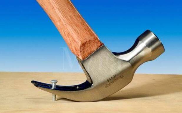

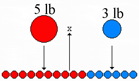

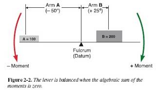

I searched some proof online but actually I want to find the proof of the kind of lever (such as Hammers pull the nails)
Thanh you!
I attach pictures ( - the proof that I had ; the kind of lever that I want to search the proof)

What you are showing is not an actual 'proof'. It is an example of where that 'law' applies. The 'Principle of Moments' can be applied (look it up) to situations where there is a fulcrum (pivot) that can be identified and where two or more forces in equilibrium and where they are acting can be identified. See-saws are the easiest examples but the principle can also be applied to a hammer and other wrenches when the geometry of the two forces is not so obvious.

Perhaps he means the "proof" of the laws of levers? It's just the equilibrium condition that the net troque must be 0. Take this figure from the corresponding Wikipedia article:
https://en.wikipedia.org/wiki/Lever#/media/File:Lever_Principle_3D.png
You take of course the gray point as the reference point here. Obviously the total torque here is
$$\tau=M_1 a-M_2 b$$
counting the component positive when pointing out of the paper. Thus the equilibrium condition ##\tau=0## tells you that ##M_1 a=M_2 b##.
