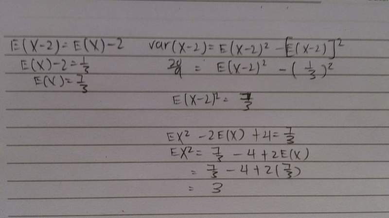

Here's the question:
Given X is a discrete random variable. E(X-2) = 1/3 , VAR(X-2) = 20/9 .
Detrmine value of E(X^2)
the ans is 23/3 . but i ended up getting 3 . why i am wrong?

##\text{Var}(X-2) = \text{Var}(X)## because ##\text{Var}(\cdot)## is unaffected by a non-random shift. Also: ##\text{Var}(X) = E(X^2) - (EX)^2##.

You made a mistake when expanding (x-2)2.

I guess I would have caught that if the OP had typed out his work, but since I never read attached thumbnails I missed it.
