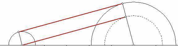

The above solution is approximate as already stated. To get an exact solution, consider the attached picture:
1. The small solid circle on the left has radius r, center C1 = (0,0) and equation y2 = r2 - x2. The large solid circle on the right has radius R, center C2 = (d,0) and equation y2 = R2 - (x - d)2. The dashed circle has radius R-r, center C3 = (d,0) and equation y2 = (R - r)2 - (x - d)2.
2. It should be clear from the geometry that the lower red line is parallel to the upper one, starts at C1 and is tangent to the dashed circle.
3. The lower line has as it's equation y = mx (i.e. y = 0 @ x = 0), where m is the slope of the line. But, m is also the derivative of the dashed circle at the tangent point (xt, yt)
4. By equating m = y/x with the derivative of the dashed circle, you can solve for xt and yt. Using these values, m can be calculated.
5. Once you know m you can find the tangent point on the large circle by equating m with the derivative the the larger circle. The same can be done with the smaller circle.
6. Once the tangent points are determined, you can calculate the "belt length" for any value of d.
7. It might be possible to come up with a single algebraic equation for "belt length" as a function of d, but it would be pretty complicated. If we assume such an algebraic expression L = f(d) can be determined, then to find the value of d, just solve L1 = f(d) for d, where L1 is the desired belt length.

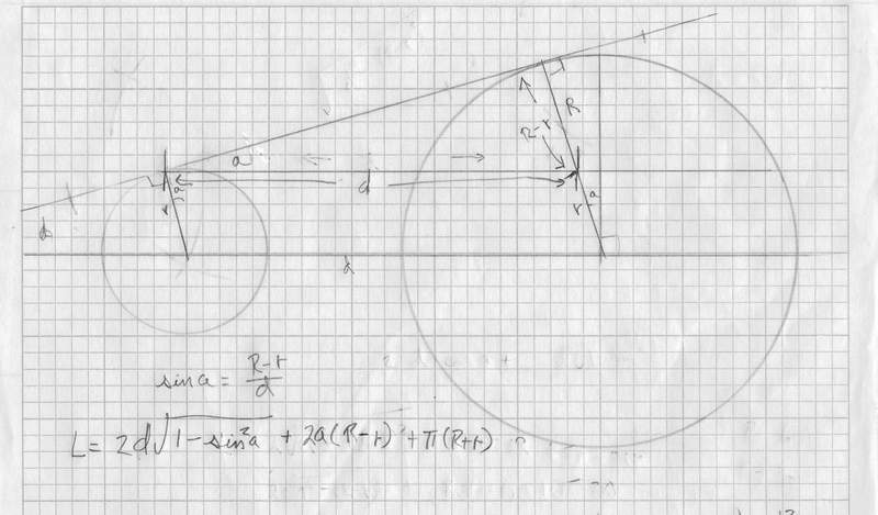

It is my turn!
See the attachment.
The hardest part is to see that the angle, a, formed by the separation of the pullies and the difference in the radius is the same as the angle to the point of tangency of the belt on each pully. Once you see that the angle is clearly given by:
[tex] Sin (a) = \frac {R -r} d [/tex]
The length of belt between the points of tangency is:
[tex] L = d \sqrt { 1 - \sin^2 a } [/tex]
For the length around the large pully we have:
[tex] L = \pi R + 2Ra [/tex]
For the small pully we have:
[tex] L = \pi r - 2ra [/tex]
Adding up the pieces gives:
Belt Length = [tex] 2 d \sqrt{1 -sin^2 a } + \pi R + 2Ra +\pi r - 2ra [/tex]

this was my first assessment, it's correct, however "a" is proving to be quite a *****
What do you mean?
[tex] a = sin^{-1}( \frac {R-r} d) [/tex]
Integral said:
What do you mean?
yup that's what i mean, and we have 2 unknowns there, "a" and "d".
And we have 2 equations.
a can be completely eliminated from the expression for belt length. So you can get an expression for d in terms of belt length. Unfortunately since d is inside the argument for sine it will not be possible to isolate it.

As for your problem I recast the result as:
[tex] d = \frac { ( bl - \pi (R+r) -2(R-r) \sin^{-1}(\frac {R-r} {d} )} {2 \sqrt{1- ({\frac{R-r} d})^2 } }[/tex]
Where bl is the belt length, I used ,
[tex] d= \frac {Bl - \pi (R+r)} 2 [/tex]
the small angle approximation to get a initial guess.
By the 2nd iteration the result is more accurate then you will have the capability of measuring.
Belt Length 50
Rb 6
Rs 2
D=
12.43362939 This is my first guess
11.74803617 This result would get you a useful separtion
11.74570521
11.74570518
11.74570518
11.74570518
11.74570518

You are correct. This is a very good solution and approaches beyond measurable precision. esspecially with the help of a computer.
thank you :)
