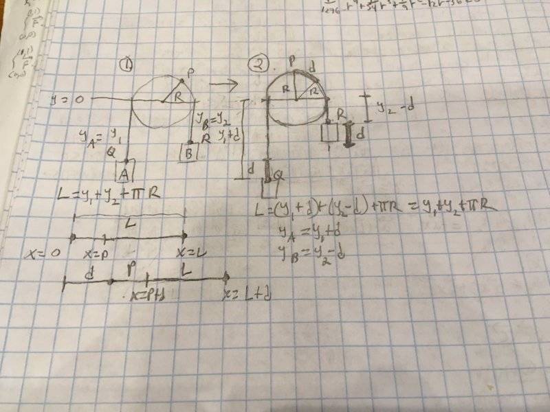

Hi everybody, I've really been struggling with this basic idea, I have drawn it out about half a dozen times, watched numerous videos, read descriptions, played with applets but I still can't see it.
Lets just start with a simple atwood machine with a massless rope and frictionless pulley. There are two masses A and B at heights y1 and y2 from the 0 point at the center of the pulley. You pull the rope through a distance d. because the rope does not stretch, the distance between points on the rope does not change(this is why the acceleration is the same for both sides of the atwood machine). I have marked points P, Q, and R in the attached diagram. As I said before, the relative distance between these points are constant. Therefore, when P moves distance d, so should Q and R since this is just equivalent to sliding the rope along a numberline (also drawn). The final y coordinates of the masses are Ya = y1 + d and Yb = y2 - d. The correct answer is stated as Ya = y1+d/2 and Yb = y2 - d/2.
What am I missing?

  • Handwritten sketches of two Atwood-type pulley setups with labeled points P, Q, R, heights y1 and y2, and a distance d, plus a number-line diagram and derivation of rope length L.

Your answer appears correct, for the problem that you state.
Wow, I did not expect to see that. I really thought I was going crazy. I did an experiment with measuring tape and got the same result as my calculations.

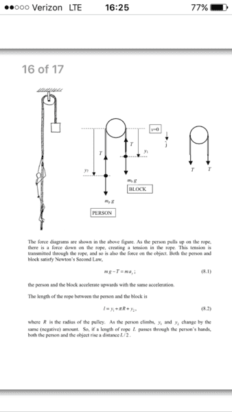

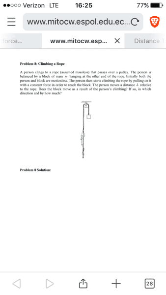

For some additional context, here is the problem I was working on and its solution. Is there an error in this?
  • Screenshot of a printed problem page titled Problem 8: Climbing a Rope, with a small diagram of a person clinging to a rope over a pulley with a block hanging from the other end.
  • Textbook page showing free-body diagrams of a person and block on a pulley system with rope tension T, weights mg, and displacement labels y1 and y2, plus equations 8.1 and 8.2 for rope length.
This is ambiguous; the problem that he states in the OP is not precisely the same as the problem in the images given in post #4. See below.
No, it's correct. But note carefully what it says: if a length ##L## of rope passes through the person's hands, then both the person and the block rise a distance ##L / 2##. Do you see the key distinction that is being made?

I see the distinction but if all points on the rope move a distance L then the block also accelerates with acceleration a to move up a distance L. When you are climbing the rope, you are accelerating relative to the rope with a as well. because there is no stretching the rope is accelerating in the same direction as the block which is -a in the direction opposite you. relative to the ground your acceleration is a-a = 0 so you are moving along the rope but staying in place as the rope moves down just as much as you climb.
What am I missing here?

That's not what the solution says. It says that a length ##L## of rope passes through the person's hands. Think carefully about what that means.
Does that mean the person moves a distance L along the rope? I can only picture myself climbing a rope and I moved a distance L along it. Because the length of the rope is constant, the L I pulled down had to come from the other end of the rope, so the point of the rope that was formerly distance L away from me is in my hand when I'm done climbing?

The key to the problem is not acceleration relative to the ground. It's the force balance. Consider: in terms of distance along the rope, the block is a length ##L## closer to the person if a length ##L## of rope passes through the person's hands. How is that length ##L## divided between the distance the person rises relative to the ground, and the distance the block rises relative to the ground?

The forces on the person, the rope, and the block. The solution you linked to describes them.
jk494 said:
I have watched videos of atwood machines
This isn't the same as an atwood machine. In an atwood machine, both sides have a block that is fixed to the rope, so the length of the rope between them is constant. In the problem you're considering, the person moves relative to the rope, so the length of the rope between them shortens. That makes a difference.
