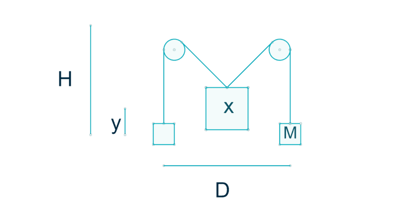

I was working on a pulley system as shown here:
The mass on the right and left side is equivalent, and I am solving for when the system is in static equilibrium. Theta is the angle between the rope on either side of one of the pulleys. H and y are both measured from the original position of mass M, not its current location (it was simply meant as a reference point). The mass of the rope and friction are ignored. I wanted to find how the distance y changes as the mass x changes.

I imagine that this system may be used as a balance, in which the sag of the rope tells you the mass of x as based on the equation. Would that be possible? Thanks in advance.
Yes it can be used as a balance. It's the angle of the rope to the vertical, not the sag, that tells us the weight of the central mass.
Could you also use the equation to find the mass of the object based on the vertical descent, or the change in y? (It may have been inaccurate to call that a sag).
No. We need the absolute level of y, not just its change, in order to calculate the angle. And we need the angle in order to calculate the force.
Yes—so if you were to know y, or the vertical position of the mass m, would you be able to determine the mass based on the formula I wrote? I should have wrote the value of y instead of the change in y.
Yes we could determine the mass based on a formula of that sort. I have not checked the calculations to see whether the formula is exactly correct.
