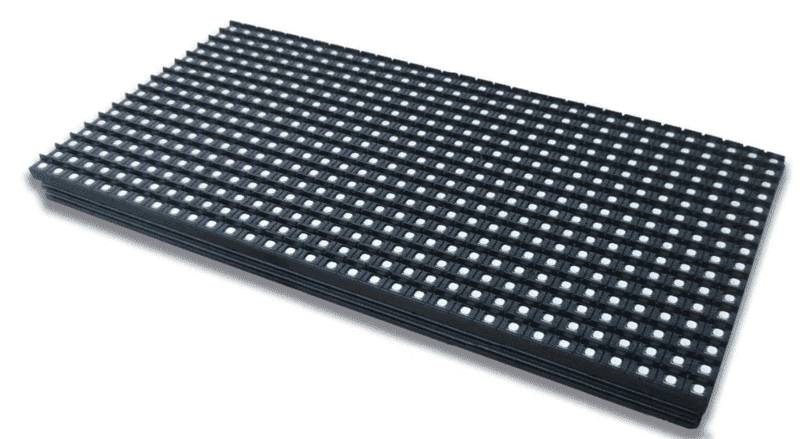

The OP was asking about LED light bulbs indoors. I was thinking about outdoor advertizing signs. Each LED in a sign can be very bright and use a lot of power. Those signs are scanned in a raster pattern like old cathode ray tubes. Only a small number of them are lit simultaneously, in the extreme only one at a time. Persistence in vision makes us see the whole message. The sign below says "1/4 scanning" which I interpret to mean a maximum 1/4 of the pixels can be lit at one time.
