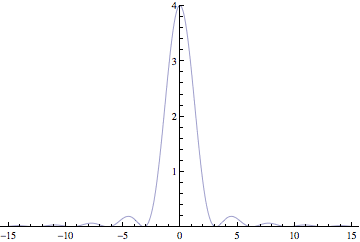

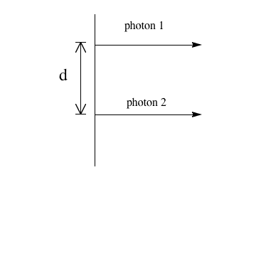

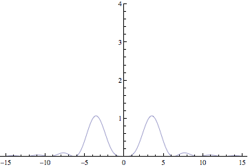

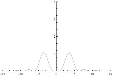

Hello all, I am a chemistry graduate student at UCI. This question (do photons have mass) came up in a discussion section for general chemistry. The student gave the following scenario and I'm a bit stumped.
Suppose 2 photons were emitted from two points on a plane separated by a distance, d and traveling with identical velocity, v , parallel to the normal of the plane.
The question is, would the paths of the two photons ever intersect?
I.e. would their relativistic masses yield a gravitational interaction, causing their paths of motion to be distorted, or would they continue on in a straight path, forever parallel?
Or, a more physical interpretation, if a measurement were taken of their diffraction pattern at a distance r from the plane, would there ever be a large enough distance such that there would no longer be two distinct loci of maximal intensity in the diffraction pattern, but instead a single locus of maximal intensity (suppose that d was such that each photon's emission location was centered upon a node for the other photon)
One overlapping intensity maximum
Two distinct intensity maxima
My gut reaction was that they would stay parallel (two distinct intensity maxima), but I'm not 100% certain.
If either one were a particle with rest mass, the answer would be that the path of the photon would be altered...
Of course a particle with rest mass would never achieve the speed of light, so the question of their paths crossing would be mute unless the particle were so massive and dense that it acted like a black hole...

GR is a classical theory, but it's fairly well known that "photons" (classically electromagnetic waves and usually abstracted as a "null dust" in General Relativity) don't attract each other when going in the same direction.
They will attract each other if they have anti-parallel paths though.
See for instance http://prola.aps.org/abstract/PR/v37/i5/p602_1
Phys. Rev. 37, 602–615 (1931) "On the Gravitational Field Produced by Light", Richard C. Tolman, Paul Ehrenfest, and Boris Podolsky.
Tolman's result might be easier to look up in http://books.google.com/books/about/Relativity_Thermodynamics_and_Cosmology.html?id=1ZOgD9qlWtsC
Wiki also has a reference, which I haven't studied closely, but looks OK at first glance that gives the metric:
http://en.wikipedia.org/w/index.php?title=Bonnor_beam&oldid=479934048
About the only thing valid about the "relativistic mass" argument is that the "relativistic mass" of photons ( which is rather more likely to be called "energy", see any of the way-too-long threads on this point) is part of the stress-energy tensor. It's actually the stress energy tensor that causes gravity in GR, not mass, or energy.
The fact that the photons don't attract when moving parallel, and do attract when moving in anti-parallel might suggest some sort of gravitational effect that mimics magnetism. This idea turns out to have some merit - in the weak field, one can draw a useful analogy between gravity and Maxwell's equations. See for example http://en.wikipedia.org/w/index.php?title=Gravitoelectromagnetism&oldid=509366342
