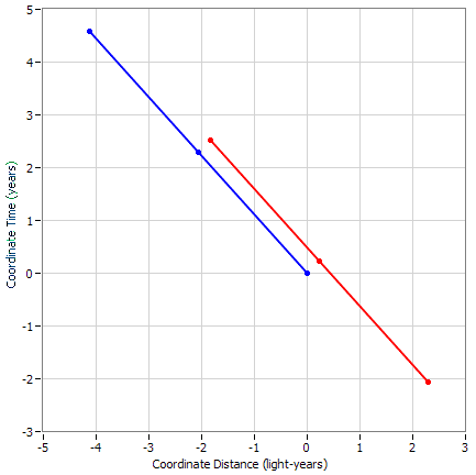

Imagine two asteroids which are separed by 1Ly distance. They are in uniform velocity (.9c) with respect to an observe in space. So from the observers point of view (rest frame), does the distance between the asteroids (ie. 1Ly) appear contracted?
If the distance between two asteroids is measured to be ##d_0## in the asteroids' rest frame, then in a reference frame where the asteroids are moving at ##0.9c## the distance will be about ##0.44d_0##.

You've left a few unspecified parameters here to give a definitive answer. When you say they are separated by 1Ly distance, we assume you mean in their mutual rest frame. When you say they are in uniform velocity, we assume you mean in a direction in line with the two asteroids. And when you ask about what the observer observes, we assume you mean what is defined according to his rest frame and not according to what he actually sees. Then dEdt's answer is correct. Notice that he also made two of those assumptions:
This is really a simple question that is best answered by applying the Lorentz Transform at 0.9c to the mutual rest frame of the two asteroids. You don't need any observer or any implication of his "point of view".
Here's the rest frame for the two asteroids where they are separated by 1Ly along the x-axis:
And here's a frame moving at 0.9c along the x-axis with respect to the first one:
Can you see that at the time of zero years, the red asteroid is displaced by 0.44Ly with respect to the blue asteroid?
Do you understand that nothing has changed in space simply by applying a different set of coordinates to the scenario?

This isn't the correct way to determine "separations in position" which is why you get a different answer than the "usual length contraction". The bottom two dots in both of my diagrams above follow your scheme and end up with a separation of 2.3Ly
(the reciprocal of the correct answer, 0.44Ly) because the new time coordinates are different. Separations, distances, and lengths between two events have to be with the same time coordinate (even though the Proper Times may be different).

It's the correct answer for his incorrect scheme and gives the reciprocal of the correct answer. This is one reason why drawing diagrams is so useful.
