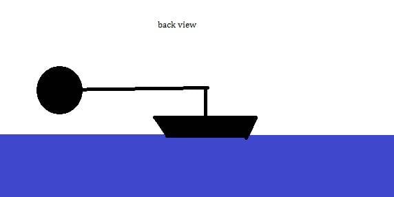

Imagine we have boat with very very heavy metal ball at left side.Neglect aerodynamic forces at ball..
When boat is going at constant speed ,nothing happened,he is going in straight line.
But if you increase throttle,increase engine thrust,boat start accelerate,boat will turn to the left because mass of ball show resistance to change speed/position..

  • #65
This is getting silly. That's because the "boat" is attached to something else, namely the large "ball". Now you have a system of boat+ball, whose CM is out on the boom arm somewhere.
The system accelerates and rotates because the force from the water is no longer directed through the CM of the system. The same would happen if you moved the engine to the side of the boat.
If you put an equivalent ball on the other side of the boat, there would be no rotation.

  • #66
for sure no rotation,because now CG will be in the middle of boat ,so engine thrust(force) act at CG...

  • #82
Any force that is not applied to an axis that does not pass through the MC creates a torque, when the force passes through the MC the length of the lever arm is zero and there is no torque, nor rotation.
In the video that you present, the force at the different ends of the boat creates different movements, as none passes through the MC, they create a moment or torque, which makes the boat rotate through its MC in the instant, but like the resistive forces of the water does not pass through the MC also create a moment with respect to the MC.
In case 1 the resistive forces oppose the turn but move the ship more, in the second case the resistive forces collaborate with the moment and the ship turns faster and moves slower.
When the ship has rotated, the resistive forces do not have to oppose the force pushing the ship in direction and direction, rather it will have a direction very close to the direction perpendicular to the ship's axis of symmetry, the unbalanced components also accelerate at ship in the ##x## direction, even though the force was applied in the ##y## direction.

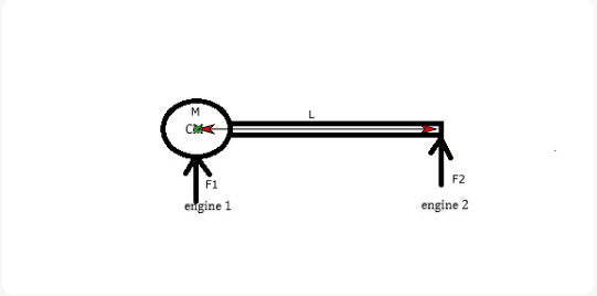

Engines are same,have equal thrust...
Stick is is deep space,engine 1 is act at CM, engine 2 is turn OFF,stick travel with constant speed v.
In time t1 I turn OFF engine 1 and turn ON engine 2.
Will stick start rotating counterclock wise or it will keep going in straight line without rotation?
If only rocket 2 is OFF, the stick will not travel with constant speed.

  • #85
I forget that in space there is no drag.
What then determine final speed if there is no drag and my engine has finite thrust?
stick accelarate to infinity?
  • #86
No, it will approach c.
  • #87
¸What determine real rocket speed in space,how fast they move in space,if drag is zero?
  • #88
The speed of everything is determined by the reference frame you choose to describe its motion.
  • #89
imagine space is fill with fluid,what is speed in relation to fluid?similar as airspeed in planes
  • #90
