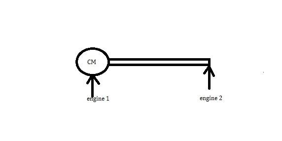

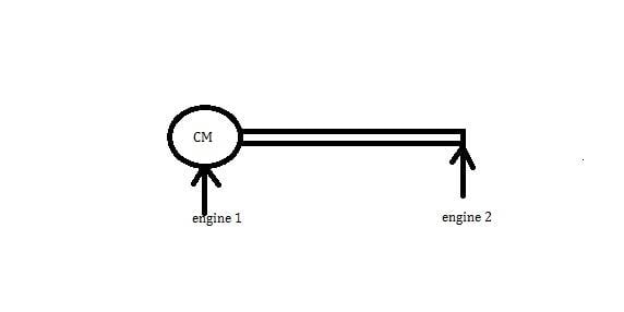

  • #96
John Mcrain said:
Engines are same,have equal thrust...
Stick is is deep space,engine 1 is act at CM, engine 2 is turn OFF,stick travel with constant speed v.
In time t1 I turn OFF engine 1 and turn ON engine 2.
Will stick start rotating counterclock wise or it will keep going in straight line without rotation?
The stick will not rotate in this case. From the problem statement, we are given that the engine acts at the center of mass. That means that the engine is just a bit right of center on that huge massy blob. Just enough right so that things remain balanced.
Please do not present drawings that disagree with the accompanying text.

  • #98
Again, you need to specify the point of rotation you are asking about. “Will stick start rotating counterclock wise about the CG or it will keep going in straight line without rotation?” If you find that too cumbersome then the word “spin” refers to “rotation about the CG” in classical physics.

  • #103
John Mcrain said:
A.T. said it will..
I think @jbriggs444 was thrown by the errors in the description and diagram. If only engine #2 is firing, which is not at/through the COM, it rotates.

  • #106
I made mistake ,because I forgeot stick will accelerate in space becasue there is no any drag to counter force ,so question don't make sense at all..
  • #107
John Mcrain said:
A.T. said it will..
I had incorrectly assumed you were firing the engine under the big mass, not the engine at the tip of the rod.
  • #108
A.T. said:
If only rocket 2 is OFF, the stick will not travel with constant speed.
If engine 2 in ON,stick will accelerate again,because in space drag don't exist.
Stick will accelerate in any combination of engines,both ,only left or only right..
Isnt it?
  • #109
You also appeared to locate engine 1 at the COM of the large object, not at the COM of the system.
But anyway, since we don't know where you are going with these questions, it is tough for us to error-check your overall logic. If you only want to know about rotation, it shouldn't matter that the system is also accelerating linearly -- we could simply ignore that. Maybe there's something else on your mind...
Isnt it?
Yes. Didn't you do this experiment with a pencil like I suggested?
