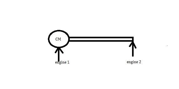

As I understand the claim to which @berkeman objected, it was that one can take an object (such as a thin rod) which is initially stationary, apply a momentary impulse at some point within the rod's physical extent and obtain a motion so that the rod has a fixed point (an instantaneous center of rotation) which falls outside the rod's physical extent.
That the rod begins rotating and that its center of mass begins translating, I think we all agree.
That the instantaneous center of rotation will be, at some times, outside the rod's physical extent, I would agree. [1/4 of a rotation after launch, the instantaneous center of rotation will be off to one side of the thin rod]
That the instantaneous center of rotation will be initially outside the rod's physical extent, I would disagree. For a uniform rod and a push at one tip, I seem to recall that the instantaneous center of rotation will be 1/3 of the way from the far end. Testing 5 seconds ago with a handy pen on desktop agrees. By no coincidence, this point is also known as the "sweet spot".
If you have a suitably concave object, one can certainly arrange matters so that the instantaneous center of rotation will initially be outside the object's physical extent. [Imagine a soviet sickle tapped on the handle end]. But for a convex object, I think not.

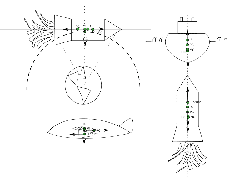

Hi @John Mcrain I will respond to the initial point that is discussed in the thread.
The definitions that I will give are very perfectible, but let's just go to the main concept.
The center of mass of an object is an object's own characteristic, that is, of the distribution in space of the different densities of the materials that compose it.
The center of gravity is different because at each point of the object there is an acceleration towards the center of a gravitating object (Sun, earth, moon etc whatever), the sum of that mass by accelerations are forces that create a couple on any point reference. In this way, the center of gravity only coincides with the center of mass when there is a symmetry with respect to the main axes of inertia, we can say it in another way, the sum of these moments with respect to the point chosen as GC must be zero.
Well, but a ship, an airplane, are not only subjected to the force of gravity but also to hydrostatic thrust forces of the environment that surrounds it and to the force of aerodynamic or hydrodynamic friction. Therefore a boat is balanced when the Center of Thrust (the point of application of all external forces) is above the center of gravity, any angular imbalance creates a recuperative torque and the boat does not list. In the rocket (at low altitude) and in airplanes, friction is the force that causes the restoring moment while the center of application of this force is ahead in relation to the velocity vector with respect to the center of gravity.

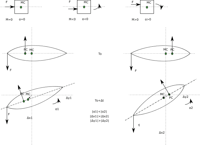

This is easily summarized, in the absence of gravity, any external force on a body has the effect of translating the center of mass and rotating about the center of mass. As near a planet you cannot avoid the force of gravity, it causes the resulting force in the same way and one moment, de say the objects will rotate with respect to the center of gravity, because in small objects, it practically coincides with the center of mass. Always the GC of a gravitationally stable object is closer to the Earth (in this case) than the MC.
When external forces act, they are distributed on the surface of the object, we can then add (integrate) all these forces to find a resultant, which will have the same effect, moving the MC and rotating on it. But as I said, you cannot avoid gravity, so only if the GC is displaced an appreciable distance from the MC, it will create a torsional moment trying to regain the previous stability.
The answer about which point broken is the MC.
If the density of the object is constant the MC coincides with the barycenter.
If the gravitational field is constant, the MC coincides with the GC, as no gravitational field is constant with the distance to the earth, then all stable objects have the GC lower than the MC, (it is a real but depreciable distance).
As long as the resultant of external forces (thrust, friction, etc.) passes through the same line of action as the resultant of gravity, then the object is translated in that frame of reference.
But if, in addition, the resultant of the external forces does not pass through the MC, it creates a torque that may or may not find equilibrium with the couple of the force of gravity, to find a new stable equilibrium or rotate with respect to the MC.

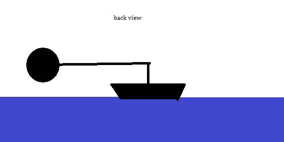

The ship pilot's discussion about a pivot point or an apparent pivot point is not something that is well defined in physics. He used the terminology many times, but never defined it. I am not sure what he means by that in terms of the motion of the ship.
The big difference between a ship and many other objects that you mentioned is that the ship is affected by large forces distributed all along the length of the hull. Those forces make it so that the center of mass of the ship is not moving inertially. The motion is more complicated than that of a free object experiencing no net force.
