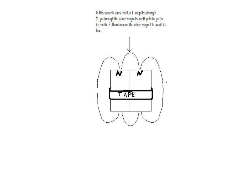

When two magnets are taped together with both north sides touching does the magnetic flux stay in its normal possition or does it bend, if it does in what way does it bend?

I have a few questions about an attached illistartion. I would appreciate it if you took a look and gave me your thoughts on it thanks.
You can't see the questions I asked so I'll tell you here. In the drawn scenario does the flux of one magnet go through the poles of the other magnet? Does the flux keep its strength? Or does the flux alter its course to avoid the flux of the other magnet.
The drawing in the attachment is not correct. The flux from two magnets squeezed together with like poles adjacent wouldn't look like what you've drawn.
What would really happen is that the flux lines would be indistinguishable from those of a single magnet of the new width: all the lines from the North end would curl around back into the south end. Lines coming from a given pole can't re-enter that same pole. All the lines coming from the South end of the magnets would also curl back up to the North end, and none would re-enter the south end. Again: taping two magnets together with like poles adjacent is like making a new magnet of greater width.
So, to correct your drawing just draw the field lines you'd have in a single magnet around the two joined magnets.

Following these principles, your diagram is wrong.
