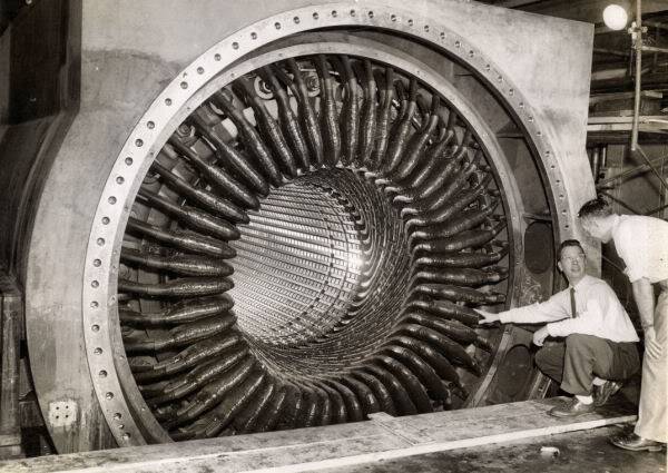

yes, in my lab so many years ago we indeed shorted the terminals of an alternator (not a real big one probably 20KW or so) and measured it with a meter. then let it coast down and observed nearly constant indication..
fifteen years later had reason to operate a farily big one (about 300mva) into a short circuit, though at only 3600RPM.
Armature current was very well behaved and tracked field current.
we actually had a flux probe in that machine and watched every rotor slot go by on an oscilloscope. that let us locate shorted rotor turns.
flux is driven to near zero by armature reaction but right adjacent the rotor conductors there's field leakage flux and we detected that
[ Not my idea, it was thought up by a GE guy named Don Allbright.
i think you'll like his site, here
http://www.generatortech.com/C-Page3-Our Company-History.html
photo courtesy of generatortech, Don Allbright ]
