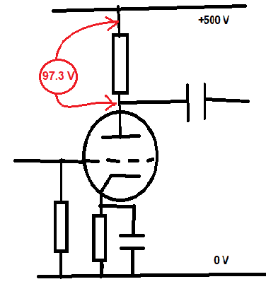

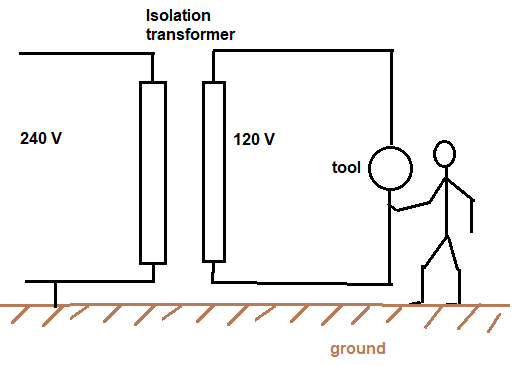

AFAIK the point about an isolation transformer is that there is no other connection of the secondary circuit to ground. If the user touches the electric supply (by fault or by error) it does not make a circuit through which current can flow and do him harm.
The secondary of the transformer is at an undefined potential wrt the ground and, when he touches part of that circuit, that point becomes grounded through him. A small transient current could flow as contact is made, but that would be to discharge any static potential that had arisen on the small capacitance of the wires. Once this is discharged, conduction through him maintains that point at ground potential. No significant current can flow, because there is no low resistance path to ground from anywhere else in the secondary circuit.
To get a dangerous shock he would need to touch two parts of the circuit, say either side of the tool, which were at 120 V pd.
kiki_danc said:
Can you give example of anything used as reference (besides ground)
here I measure the anode voltage (= 402.7 V wrt chassis 0 V ) by measuring the pd wrt to the +500 V line. I may do this because the anode resistor is simply a convenient place to attach my meter, or maybe my 100 V range (or other low range) is easier to read accurately than the 500 V range.
(BTW I can't think of any reason this circuit would be biased like this. Its just for the sake of argument ! Though perhaps I could make it into a class B/C amplifier with a few mods?)
Edit: scrub the decimal of the voltages. Even on the 100 V range I couldn't read 0.3 V ! That was just me trying to show an accurate reading. I'd probably be able to estimate to 1 or 2 V on the 100 V range, but only to 5 or 10 V on the 500 V range (or the 600 V range which I would need to use on my meter.)

My electricity is identical to USA and I'm very familiar about the ground wire needing to be bonded to neutral only once at service entrance. I can easily connect the ground to the secondary output of the isolation transformer, but the isolation would be lost. Hence concerned how the potential could rise by its own. I was concerned the potential could even rise to the vev (vacuum expectation value) of the electroweak plasma potential and I don't want this happening near my room, but you commented it won't happen and the potential rise could occur by rubbing the transformer in the door knob and the amount of charge will be small.
But then, if one of the 120v leads of the secondary output of isolation transformer touches another 240v live, then the output would become 360v or 240v?
Why would this be a concern if the transformer and its mounting is properly constructed?
I cannot provide any advice beyond what what I would surmise might happen in a given situation. I am not licensed to dispense instruction to guarantee conformance with your local electrical codes, and will not accept the potential ramifications of doing so. If this is a Do-It-Yourself (DIY) project where you are building your own step-down / isolation interface to the mains, I'd suggest consulting a local licensed electrician to approve your build.

Actually. I buy isolation transformer just to understand the concept of magnetic flux. In my country. We don't have any isolation transformer. We only have autotransformer. But as I learned in this thread, autotransformer also has magnetic flux and same principle.
At least please share the hypothetical situation that if one of the 120v leads of the secondary output of isolation transformer touches another 240v live, then the output would become 360v or 240v? The logic is that if you don't ground the secondary, and the neutral is bitten by rats and it touches a 240v source, the neutral can take that value... and secondary voltage may change, true? so if the secondary is 120v.. and one lead touches a 240v source, would the total become 360v or 240v? Of course I won't try it.
The potential difference variation between the transformer leads would remain 120 V. Your load device would remain happy. The potential of the "shorted" lead and the other lead with respect to your mains wiring neutral or ground would vary according to mains voltage (240 V). This would not affect the connected load, since it only "sees" the transformer leads. You would definitely have a problem with exposed wiring/chassis on your load device, since it'll share the potential of a "iive" wire. Not a happy circumstance.
No. The secondary is isolated. The neutral is on the mains side of the circuit. The rat will die, the GFCI will note the ground current and trip the breaker. The neutral is bonded to ground as you've already stated in a previous post, so it won't change potential w.r.t. ground (ignoring any small resistance in the bonding wiring). Your load is safe in this situation (in my unlicensed opinion). The rat is not safe of course :smile:.
