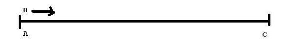

Perhaps I can help you from a layman point of view.
First of all (and as I had already had too many from PF) this has nothing to do with acceleration. Altough acceleration plays a role, but very little. It's about changing frame of reference.
But, let's forget about Twins Paradox. Why don't we talk about Doppler.
Suppose you (A) have a friend (B) who keeps sending you a signal/sec.
So, you're receiving B signal, 1 signal / sec. Now B travels 0.6c.
Now after 1 sec, B arrive at C.
When will this signal reach you?
So, in 1 sec B will be as far as 0.6ls from you. So this signal will arrive at you at 1.6 sec.
So, from the original 1 sec for a signal, you'll have 1.6 sec for a signal.
No, wait. This is not SR.
B "experiences" time dilation wrt A (what ever "experiences time dilation means")
wrt means With Respect To
And I see that you have understood SR
idea2000 said:
I have learned sr to the degree where...
PeroK said:
If you understand SR, why do you care?
So you must know that 1 sec for B isn't 1 sec for A
So 1 sec for B is 1.25 sec for A, you can check the explanation in Lorentz Factor in Wiki.
So in 1 sec wrt B, B will send it's signal. But where is B actually? B of course would be at 0.75 ls away from A wrt A. How would A know that B is 0.75ls away from A? A can then check to his friend C whom A knows exactly at 0.75 ls away from A.
A can then ask C "Do you meet B? What is your clock (C) reading when you see B? Can you see B's clock reading? What?
C will answer. I meet B when my watch shows 1.25 sec.
I see B clock 1 sec.
Now when will this signal reach A? This signal will reach A at 0.75 (AB distance wrt A) + 1.25 (A's clock) = 2 second.
So when B travels away from A, A will see that B clocks ticking half it's rate. And B will see A's clock is as slow as half B's clock as well
This you can check for yourself in relativistic Doppler Effect ##k = \sqrt{\frac{1+v}{1-v}}##
And this goes also if B is APPROACHING A, the effect is reversed. A will see B's clock ticking twice faster then A's. And vice versa, B will see A's clock ticking twice faster as well.
Okay, so much for Doppler.
Now we have k = 2.
So, suppose.
A and B meet.
Then B travels away from A at 0.6c to C 300 ls away.
When B reaches C, how many signals from B that A receives and vice versa?
Traveling 0.6c for 300 ls away takes 500 secs.
So A will receive 250 signals from B. A has sends 500 times, but A only receives 250 times from B. It's ok. It's the effect of Dopples (plus relativity, otherwise, A will only has 125 signals)
So does B, B will receive 250 signals from A.
This is SYMMETRICAL
Now B travels B to A.
When B reaches A, how many signals from A that B receives and vice versa?
Because two partys are approaching each other, B will receive 1000 signals.
And A will receives 1000 signals-------------------------------
No, that's not the case!
A will not know that B is traveling to A until 300 secs later!
Because it's B who does the traveling!
Imagine that right now you travel to the Sun, you'll imediately see the Sun gets bigger, right. But if the sun is doing the traveling, you won't know the sun gets bigger until 8 minutes later.
--------------------- this is 'asymmetry of twins paradox ------------------
A still receives 150 signal from B for 300 secs, and then A will receive signals from B every 0.5 sec.
How many signal that A have from B after that?
So.. B will be at 120ls away from A. It takes another 200 secs for B to reach A. A will only have 400 signals from B.
Okay, I'll summarize for you.
From B point of view.
B1. From A to C, B receives 250 signals.
B2. From C to A, B receives 1000 signals.
From A point of View
A1. From A to C, A receives 250 signals.
A2. From C to A (the first 300 sec), A receives 150 signal.
A3. From C to A, the rest 200 sec, A receives 400 signals.
Ok, so let's analyze it deeper.
B1. For 500 second, B see that A ages 250 seconds.
B2. For 500 second, B see that A ages 1000 seconds.
From A point of view
A1. For 500 seconds, A see that B ages 250 second
A2. For 300 seconds, A see that B ages 150 second
A3. For 200 seconds, A see that B ages 400 second.
The symmetry is B1 and A1
B2 and A3 in also symmetry.
But the trick is in A2.
Hope you can understand it as I did 1 year ago :smile:

I've found a video that seems to illustrate the concepts that people have been posting in this thread.
I'm still confused about what he says at about 8:10 in the video, though. He seems to put the aging for the coasting periods together to show that there is no age difference during the periods where there is no acceleration. Is this correct?
Thanks for any replies in advance!
The only place where there is an acceleration is the POINT midway through the trip (the point labeled 4), but your video shows that the aging difference occurs along an INTERVAL (all the red dots).
Point 4 is the only place he accelerates, yet the aging difference occurs in Earth's frame from point 4.5 to point 7.5, and in the spaceship's frame from point 4.5 to 5.5.
The acceleration causes the traveler to change reference frames, and the different reference frame directly causes the time discrepancy.
As an analogy, the acceleration is like when you're driving and you take a turn to a road that causes you to take a longer trip. You're only turning for a few seconds. It's the PATH you take that makes the trip longer- the DIRECTION. With the twin paradox the acceleration changes your reference frame, and it's moving in the new reference frame that directly causes the age difference, as can be seen in your video by looking at the intervals with the red dots.
Battlemage! said:
The only place where there is an acceleration is the POINT midway through the trip (the point labeled 4), but your video shows that the aging difference occurs along an INTERVAL (all the red dots).Point 4 is the only place he accelerates, yet the aging difference occurs in Earth's frame from point 4.5 to point 7.5, and in the spaceship's frame from point 4.5 to 5.5.
Okay, I have a better understanding of what you are trying to say now. The mistake we make when analyzing these scenarios is by assuming that the twins are seeing each other at the same age. What pervect, and stephanus, and you were trying to show me, was that they are NOT seeing each other at the same age. So, when Earth twin sends a signal from 1, on his axis, we think that he must be sending that signal to space twin's 1, when, he's not. He's sending the signal to space twin's 2. And when space twin is sending a signal from 2 to Earth twin, we think he's sending the signal to Earth twin's 2, or, at least, back to 1, but, he's not. He's sending the signal to Earth twin's 4.
The difference in aging arises when he changes direction, but, not only at the acceleration point, but, also beyond that point as well. So, if he decided not to slow down and turn around, and he had just kept going along the same worldline, he would have sent a signal from his 3 to Earth twin's 6. And Earth twn would have sent a signal to his 12 (not shown on the diagram). But, because he turned around, Earth twin sent to his 6, instead. You could also create a scenario where the space twin would slow down to be in the same frame of reference as Earth twin, and just keep moving along. When you look at his worldline in this case, he would just be horizontal to Earth twin. And you could just keep plotting the lines like you were doing before.
Seems like you could resolve almost any basic paradox in sr this way. Since, I'm guessing that these paradoxes usually revolve around what happens first and what happens next. Special thanks to Battlemage, and Pervect, and stephanus for all the help they gave me! And for spending so much time creating their explanations! =)
I really appreciate everything. =)
