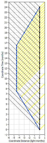

Orodruin submitted a new PF Insights post
A Geometrical View of Time Dilation and the Twin Paradox
Continue reading the Original PF Insights Post.

What do you think of this derivation of the space-time diagram from the traveling twin's perspective?
As described in this paper: http://arxiv.org/pdf/gr-qc/0104077v2.pdf
I think many people are interested in the traveling twin's perspective.
This diagram is bizarre because both twins are in the SAME FRAME for a finite duration of time, this is not the case in the staying twin's frame.
And despite both being in the same frame, the traveling twin sees the other twin undergo time compression (the opposite of time dilation).

This is full of misconceptions. First of all, all objects exist in all frames. Frames are just different ways of assigning coordinates to events. You can use any viable frame to describe any situation as long as you do it properly. Some frames are better suited for the analysis, but that does not imply a special status. The "radar coordinates" introduced in the paper is a non-minkowski coordinate system. You should be as little surprised about having different proper time per radar time as you should be that changing a polar coordinate results in different displacements for different distances from the origin in normal Euclidean space.
Apart from that, I do not see anything particularly new or of additional pedagogical value here. Just the added complexity of not using a minkowski coordinate chart.

By "same frame", I mean same inertial reference frame. Both being at rest w.r.t. each other.
I'm not sure what you mean by "special status", I don't think I mentioned that any frame had a special status.
The "time compression" may be viewed as a form of gravitational blueshift. This and the "same frame" effect are described as being due to "shock like scale discontinuity".
Speaking of additional pedagogical value, I was just curious about the traveling twin's perspective. I think many people have never seen such a diagram before too.
Whether the twins are at rest relative to one another has nothing to do with whether they are in the same frame. Both twins are always in all frames all the time.

Note that radar coordinates are exactly Minkowski coordinates if the defining world line is eternally inertial. They are asymptotically the same as Fermi-Normal coordinates near the defining world line. They have the specific feature that as long as the defining world line is inertial for all proper time before some event, and also inertial for all proper time after some event, no matter how complex the motion in between, and however 'long' such complex motion occurs, they give a complete coordinate chart of Minkowski space (unlike Fermi-Normal coordinates). Thus, they can be seen as a generalization of Minkowski coordinates to describe the 'experience' of a non-inertial observer, having several nice properties (including also they are built from more achievable measurements than positing very long rulers).
All the same, one must never attach 'more reality' to a description in radar coordinates than in some other coordinates.

I like it. It is one of my favorites.
That said, I wouldn't worry too much about details like the part of the trip where the distance is constant. It is a non-inertial frame so distance and speed don't have their ordinary meanings anyway. The point is mostly that the traveling twin's "perspective" is not symmetrical to the home twin.

But exactly here lies the problem. I am not arguing that the coordinates are abad idea, I just question the pedagogical value to people who are just learning relativity. I do not see the point of introducing non-inertial coordinate systems on top of the struggles they already have.

I agree. Pedagogically, for a novice I would encourage them to stick with inertial frames. Then if they persist use the paper in the spirit of "your question does have an answer, here it is, come back to it when you are ready".

As a follow on we could consider "what if there were only two observers?".
Well, what did the second observer do? Did he turn around instantaneously experiencing infinite acceleration (a non-physical physics problem)? What if he accelerates and decelerates gradually over time? What if he slingshots himself around another planet experiencing weightlessness the whole way? It may very well turn out that all of these produce the same result because spacetime does not get curved and SR still applies (or maybe not). Volumes have been written about all these various scenarios.
the_emi_guy said:
These folks are better served by showing them how simple application of time dilation to all three inertial frames (see post #18) shows this in a trivial and intuitive manner (and I do mean "inertial frames" here, with each observer at rest in his frame).
Whether this is "trivial and intuitive" is debatable (see below), but it seems to me that these folks would be served better still by giving them the most general method of all: spacetime geometry and lengths of curves. What we have here is a triangle in spacetime: one side is the stay-at-home twin's worldline, and the other two sides are the traveling twin's outbound and inbound worldlines. Then all we need is the Minkowski spacetime analogue to the Pythagorean theorem--of which the time dilation equation you are implicitly using in your method is just a special case.
That's not a follow-on; it's how the original scenario was posed. When you formulate it in terms of three observers, you are, on the face of it, talking about a different scenario. You then have to explain how the result you derive with three observers gives the right answer for the case of only two, which was the actual scenario posed. This is certainly doable, but I question whether it is "trivial and intuitive" to a person who is struggling with time dilation and differential aging.
The first case is the one that is equivalent to your analysis--although I would prefer to phrase it in terms of taking the limit as the turnaround time (the time elapsed on the traveling twin's clock during the period when he is accelerating to turn around) goes to zero. The key point is that, if the answer we are interested in is elapsed proper time for the two twins, we don't really care about the details of how the traveling twin turns around, as long as the time elapsed on his clock while doing so is negligible compared to the time elapsed on his clock during the inbound and outbound legs.
The second case, accelerating and decelerating gradually over time, is not equivalent to your analysis. And the simplest way to state the reason why is by using spacetime geometry and worldlines: the worldline of the traveling twin is different in this case than it is in the idealized case you are analyzing (which is equivalent to the idealized case of instantaneous turnaround). So you would not expect the traveling twin's elapsed time to be the same. It will still be shorter than the stay-at-home twin's elapsed time when they meet up again, but by a different amount (which will depend on the details of how the twin accelerates and decelerates gradually). The spacetime geometry method adapts easily to this case; it just amounts to evaluating arc length along a curve instead of a pair of straight lines.
The two cases above can both be formulated in flat spacetime. The third, by contrast, requires curved spacetime, because in flat spacetime there is no way for the traveling twin to turn around without feeling acceleration, whereas in this third "slingshot" case, the traveling twin is weightless, feeling no acceleration, the whole way. The spacetime geometry method carries over to this case with no problem at all, since, as I noted, it is completely general.
Peter, thanks for the thoughtful response, I appreciate it.
I think that there is unrecognized value in seeing that an outbound (non-returning) observer sees Earth clock running slow, later synchronizes his "ahead" clock with an inbound clock, then watches the inbound clock go from being ahead to being behind Earth do to the greater inbound vs. outbound relative velocity. Note that this clock skew is relative to outbound's local clock, Earth's clock ended up being behind, and inbound's clock even more behind.
Doing this in all three observer rest frames and getting the same clock skew I think is compelling to a beginner, and the concept of proper time was not even needed or required.
