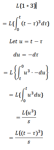

Use the substitution ##u=t-\tau## on the integral to convert it to a more familiar form.
Any suggestions?
Remember that ##u## is a dummy variable.
Yeah, I substituted it back in the last step so there is no more u. I'm not sure how that would help me.
I don't think you understood my point. In the integral ##\int_0^t u^3\,du##, it doesn't matter what letter we use for the variable of integration. It's a dummy variable.

If you evaluated the integral, what variable is it a function of?

It's a function of u which is the same thing as saying it's a function of t - tau.
Really? Did you actually calculate ##\int_0^t u^3\,du##?

No, I didn't. The textbook says to apply the identity under "2. Homework Equations " first.
You wrote
Turion said:
$$L\{ \int _{ 0 }^{ t }{ f(\tau )d\tau } \} =\frac { L\{ f(t)\} }{ s }$$
What variable is ##f## a function of on the left-hand side? What variable is ##f## a function of on the right-hand side? Are they the same? Why not?

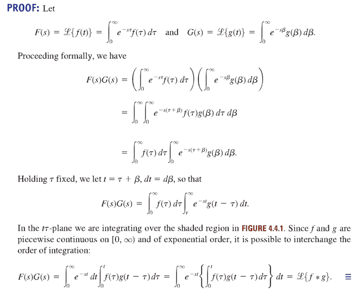

On the left hand side, f is a function of tau. On the right hand side, f is a function of t. They are not the same. I'm not sure why they're not the same but I can dig up the proof for it I guess. I think they're not the same because we're doing a transformation.
I found the proof:
Honestly, that proof (as most proofs) went right over my head.
