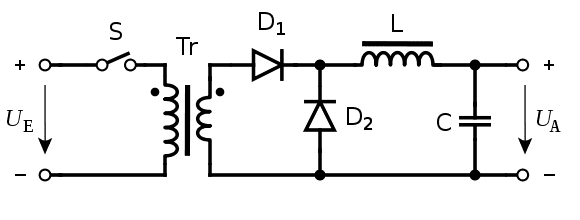

I am not sure if I have understood the dot convention correctly,
but my idea is based on the tendency of the inductor refusing to change the current(magnetic flux inside it to be more accurate).
Take a look at this picture:
At the very beginning when the switching is open(in OFF mode), no current flowing in neither primary and secondary.
Consider only the primary side,
when we close the switch(turn to ON mode), current starts flowing clock-wise in primary, that is, current flows into the dot.
And that the inductor shows a tendency to keep the current(zero current), that is, tries to push the current out of the dot creating a backward current flow tendency.
The same idea applied on the secondary side, the inductor(the transformer one) on the secondary side presented the same tendency as primary side transformer inductor did, pushing current out of the dot, eventually causing a clock-wise current flow on secondary side.
For an opposite case, consider the same circuit but at a steady state that clock-wise current has flown in the two sides for some time, that is, during the ON state(when the switch is close), we suddenly open the switch.
No doubt the current flow in the primary side is cut(neglecting leakage inductance and assume perfect coupling), the transformer inductors then present a tendency of current flow, that is, to keep the current flowing clockwise in primary side, which means the primary side transformer inductor tries to push current into the dot, and therefore the secondary side transformer inductor too, the secondary inductor tries to present a anti-clockwise current flow at this time. That is also the reason an extra diode is added at the right of the transformer output at the secondary side to prevent such anti-clockwise current flow from happening.
Eventually we have a "buck" converter with galvanic isolation.
This is for your reference, I am not sure the correctness of my speech and in case you found any errors, please feel free to tell me.
