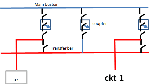

thank you very much, my ckt is this, what type of faults we will over come using improved diagram as you mention . is my system also same as your improved one. ?
Tinypic placeholder graphic reading 'THIS IMAGE OR VIDEO HAS BEEN MOVED OR DELETED' with the Tinypic logo above it.
It seems to me this one fits what I said "an improved diagram”, indeed.
However, these are actually two section of the same busbar.
This system permits to work on a one busbar -clean or repair insulators, potential transformer or else.
No circuit breaker can be substituted- all transformer or feeder circuit breaker will remain in circuit .
If both busbars are energized and coupler circuit breaker is kept close then the transfer from one busbar to another is realized by closing the disconnector connected with this busbar without any interruption.
An actual transfer bar facilitates use the coupler circuit breaker instead of anyone of the transformer or feeder circuit breaker. See[for instance]:

Single-line diagram of a substation switchyard with a main busbar on top, a transfer bar below, and three circuit breakers with disconnectors linking them; a coupler breaker sits between them, and one feeder is labelled ckt 1 and another TF1.
