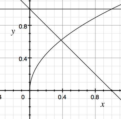

Find the volume under the surface z = y(x+2) and over the area bounded by y+x = 1, y = 1 and y = sqrt(x)
Based on the geometry of the bounds, I broke this integral into two parts. I first found the intersection of the sqrt(x) and y = 1-x. This is at x = [itex]\dfrac {1} {2}\left( 3-\sqrt {5}\right)[/itex]
Then my first integral was this:
[tex]\int _{x=0}^{x=\dfrac {1} {2}\left( 3-\sqrt {5}\right) }\int _{y=1-x}^{y=1}y\left( x+2\right) dydx[/tex]
and my second integral is this:
[tex]\int _{x=\dfrac {1} {2}\left( 3-\sqrt {5}\right) }^{x=1}\int _{y=\sqrt {x}}^{y=1}y\left( x+2\right) dydx[/tex]
However when I solve this integral, I don't get the correct answer (which should be 9/8 according to the solution).
Where am I going wrong?
Thanks!

What was your final answer? I do not get the value 9/8, either. In fact, since 9/8 > 1 it cannot be the correct answer, for even getting a crude upper bound gives an answer < 1. Below, let
[tex]a = \frac{3}{2}-\frac{\sqrt{5}}{2} \doteq 0.381966012[/tex]
be x-value of the intersection between the square root and the slanted line.
The base of the first integral is the right-triangle with sides ##a## and ##a##, so has area ##A_1 = a^2/2 \doteq 0.07294901715.## A simple upper bound on ##z## is ##z \leq 3## for all feasible ##x,y##, so the first integral, ##I_1##, has the simple upper bound ##I_1 \leq U_1 = 3 A_1 \doteq 0.2188470514##.
The base of the second integral is a "triangle" with a curved hypotenuse, so has area less than a true triangle with the same base and height; that is we have:
[tex]\text{area}_2 < A_2 \equiv a (1-a)/2 \doteq 0.1180339888[/tex]
Thus, an upper bound on the second integral, ##I_2##, is ##I_2 \leq U_2 = 3A_2 \doteq 0.3541019664##. An upper bound on the whole double integral is ##U = U_1 + U_2 \doteq 0.5729490180.## This is a lot smaller than the claimed value of 9/8 = 1.125.
Also, I would point out that, given the shape of that region, a dxdy order of integration allows setting up only one double integral.
@Zondrina: I don't think there are 4 double integrals because this area is bounded by y = 1 and comes to a point at the intersection of y = 1 - x and y = sqrt(x)
@Ray Vickson: yeah I get a number much smaller than 1. I calculated the integrals on wolfram alpha and I ended up getting something like .38@LCKurtz: I'm not sure I understand what you mean. Care to explain more?

I mean put the proper limits on$$
\iint y(x+2)~dxdy$$Just one double integral is necessary.
Yes I didn't notice this when I was sleepy. The region looks like it's divided up into three pieces, not four (somehow my brain convinced me there was a line at ##x=1## last night); The left triangle like piece, the upper triangular like piece and the bottom piece.
The limits for ##x## appear to be different in each region, as are the limits for ##y##. If I'm seeing this now, it looks like you would need five integrals. Not quite sure how you would do this with just one integral.

Intuitively, you have chosen to split up the base area into thin vertical slices parallel to the y-axis. Essentially, the suggestion of LCKurtz is that you split it up instead into thin horizontal slices parallel to the x-axis.
Graph in the x-y plane with x from about 0 to 1 and y from 0 to 1, showing a horizontal line at y = 1, a straight line falling from (0, 1) to (1, 0), and a curve starting at the origin and rising to the right; the curve and the straight line cross near (0.4, 0.6).
@Zondrina: The only region that is described in the original post is the upper one, and it takes one double integral if done as a dxdy integral.
I see all the lines only have one region where they all form a closed boundary.
Thank you for clarifying that.
