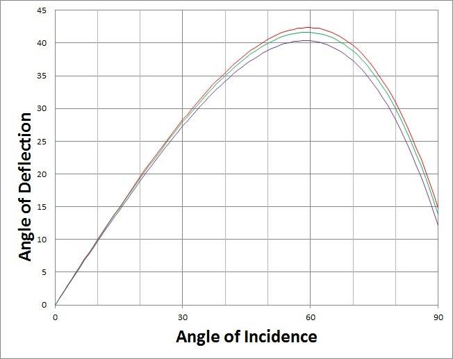

Maybe you missed my point. The rainbow is formed by light that hits the entire surface of the raindrop, not just a single ray. After internal reflection, that light is confined within a cone whose center depends on whether you are considering light that reflected an odd, or even, number of times inside the drop. Here's a comparison for the first and second rainbows (the colors are to help you follow the path of each incident ray; both are actually for red light):
Light that hits the center of the drop, and exists after one internal reflection, reflects directly back towards the sun. Technically, we should call that a 180° deflection, but since we observe rainbows by looking away from the sun along the line you described, it is easier to call it 0°. Here's a plot of this for three colors (and here, the color in the plot does indicate the color of the light):
See how it starts at a deflection angle of 0°, and increases to around 40° to 42°? The rainbow exists at all of these angles; but at most of them, all colors exist with about the same brightness, so we see white. Above 40°, some colors drop out, and we see colors. This is amplified by how the flatness of the curves near the maximum makes the colors brighter there.

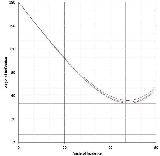

Here's the same plot for the secondary rainbow:
Since there are two reflections, light that hits the drop in the center technically deflects 360°, but we call it 180° when we look away from the sun. The white part of the rainbow is now at angles greater than 54°, as opposed to less that 40° for the primary rainbow. The colors "drop out" as the observation angle decreases below 54°.

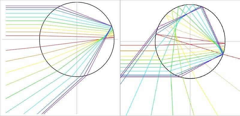

@JeffJo: I see what those two ray diagrams are trying to do but it confuses me that the incident rays are coloured before they enter the drop. I see that you have the problem of representing a range of entry points on the drop and the resulting caustic curves PLUS the dispersion. Quite a mess to represent to suit everybody. I also don't see how you appear to have total internal reflection with almost normal incidence on the far side of the drop. How can that happen if TIR only works beyond the critical angle? And again, the graphs are for different wavelengths but with what entry points?
I also see what you are saying about white light being the resultant of equal contributions over the drop except for a selective range of angles. I have always taken issue with people who seem to claim that the Rainbow Colours are 'pure' when, in fact, they are pretty desaturated.
I can still see no essential reason for choosing your reference angles differently for the two orders of rainbow. The only consequence of using the anti-solar direction would be that some of the angles from the secondary rainbow would be obtuse, which we could cope with, surely??

Did you read the part where I said "the colors are to help you follow the path of each incident ray; both are actually for red light"? They don't represent the color of the light, which is red in both plots.
Since TIR is not involved in the process of rainbow formation (and in fact is impossible in spherical raindrops - A good exercise for a beginning geometry student, who knows what an isosceles triangle is, is to prove it),

The label of the axis is "Angle of Incidence." It means the angle that a ray of light, which is incident upon the spherical raindrop, makes with the surface normal there. What you describe is the range of values the dependent variable can have. I call the variable A, and it does go from from 0° (light that is centered on the drop) to 90° (light that would graze an edge).
The formula for these plots is D(A,N,r) = 180°*(N-1) + 2*A - (2N+2)*B(A,r).
r is the index of refraction
N is the number of internal reflections (N=-1 coincidentally describes light that reflects externally)
A is the angle of incidence of the original sunlight. (Lewin calls it "i")
B(A,r) = asin(sin(A)/r) is the refracted angle (Lewin calls is "r")
D(A,N,r) is the angle where a viewer who is looking toward the anti-solar point would see the reflected light.​
Note that the reference to the observer's position is for convenience only. It is not a part of the actual process of rainbow formation. So your choice of using it is an arbitrary choice. It would be more general to leave the observer out, like The Calculus of Rainbows does, but I try to use more familiar values. But what I was trying to explain was why the colors are in a specific order. This is not a function of the observer's position.
The rainbow forms because, for N>=1, these functions have an extremum at A=asin(sqrt(1-(r^2-1)/(N^2+2N))).
If N is odd, this extremum is a maximum; if N is even, it is a minimum. This because if N is odd, D(A,N,r) starts at an angle equivalent to 0°, and increases. If it is even, it starts at an angle equivalent to 180° and decreases.
Red light has a lower index of refraction than violet light, so its max/min deviation is always further from this starting point than violet's max/min deviation. And its band in the corresponding rainbow is always further from the starting point (so it is quite literally "on the outside") than violet's. Whether you observe red to be higher, or lower, depends on which quadrant the max/min ends up in and whether it is a maximum or minimum.
For example, if the index of refraction were around 1.13 instead of 1.33 (I may have said this backwards earlier), then both rainbows would be seen in the order ROYGBIV from "top" to "bottom." The primary would be seen around 80° from the anti-solar point, instead of 40°. The secondary would technically be 200° from the sun, instead of 130°, but you could call that 20° from the anti-solar point after changing the reference and adding one more quadrant change.
This is why you have to understand how the rainbow is a full circle that is centered on 180°*(N-1) in order to explain the order of the colors. Whether the light enters the "upper" or "lower" half of the drop is not directly relevant - it just happens to coincide with the results when r=1.33.
Thank you for bearing with me. I have been reading what you have written and my thinking / drawing have taken me to a Damascene moment. You cracked it when you pointed out that the light is never totally internally reflected. Also, you said
Looking at the two ray diagrams, way back, I was assuming they referred to two different light paths through the drop. BUT, of course, if they had been drawn to proper angular scale, the first and second order (and subsequent) rays start with the first ray as it enters the drop. that ray can bounce around and around inside the drop, releasing some light at each bounce. It is not necessary to have two different diagrams as what happens to a given wavelength could be shown in a single diagram, with the first and second exits (etc.) being at different angles. Usually the result from a white ray will be white rays emerging but, when those graphs happen to be near a minimum or maximum, there will be visible dispersion in just one direction.
The usual 'helpful' diagrams (the ones I posted and the ones you posted plus others) all give the message that there are different paths though the drop for the different orders, which distract the mind from what really is relevant. It is all about the maxima and minima that you describe, which determine the angles at which a colour will emerge.
It is worth noting that it was only when I drew the drop and rays without any reference to an observer that the mechanism became clear. Once one gets the pattern from a drop, you can then place your observer somewhere and do a transform to determine what he sees. (Again, you made that point earlier on.)
