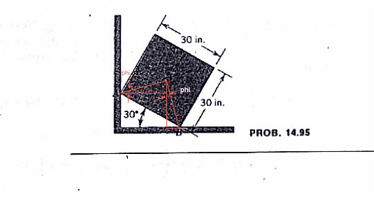

Free-body style diagram of a square box leaning against a vertical wall and horizontal floor, labeled 30 in. on two sides, with corners A and B marked, a 30 degree angle at the floor, phi marked inside, and red construction lines. Labeled PROB. 14.95.
The 500lb box is released from rest in the position shown. The wall and ground are smooth. Determine (a) the angular acceleration of the box, and (b) the reactions at corners A and B at the instant after release.
**G = center of mass
**L = length of side = 2.5ft
**phi = 15 degrees (found through geometry)
ƩF = mag
ƩM = Igα
aa = ab + α x ra/b
Okay so the two assumptions I'm working off of here are that points A and B have kinematic constraints, the constraints being that they have to travel along their respective walls; A can only travel downward (-j) and B can only travel sideways (+i) the instant they are released. So these are the two equations I started with:
ƩF = FA(i) + (FB-mg)(j) = maG
ƩMG = (√2/2L)sin(phi)FA+(√2/2L)sin(phi)FB = 1/6mL2α
I then solved for α using the sum of the moments and put it into this equation:
aA = aG + α(k) x rA/G
Here, if A can only accelerate in the j direction, then that means its i terms sum to zero so I pull out the i terms:
{the first term comes from my F=ma equation, aG}
(FB - mg)/m + (6d2cos2(phi)(FA+FB))/(mL2) = 0
I then use the same relative acceleration equation with point B and the same kinematic constraints of all the j terms in this equation summing to zero since B can only move in the i direction:
FA/m + (6d2cos2(phi)(FA+FB))/(mL2) = 0
Now I have two equations and two unknown reaction forces so it should be straight forward, but I get a negative value for FA... I can't help but think that it boils down to a sign error or a faulty cross product somewhere but I've looked over it for 3 hours and I can't find anything mechanically wrong with it. Also, a friend told me that the reaction force at A should be zero, but I'm not sure if he's correct on this. It kind of makes intuitive sense that it would be zero but I can't for the life of me figure out how to mathematically get a positive value for FA, much less get a zero value for it. Any help on this would be immensely appreciated. I'm sorry for the long post.

I think I got it, I used the equations of relative accelerations first to get linear acceleration in terms of alpha and then put them into the sum of moments and forces to some for alpha. Thanks for your help though!

It actually turns out that the reaction force at A is supposed to be negative... And then you're supposed to assume that that means the reaction force at A is actually zero since it can't be negative, and then you redo the calculations under the assumption that A is zero. I don't really know how I feel about being supposed to make that assumption but it's good to know that my answer was right the first time because I couldn't understand why conceptually it was the wrong approach.
it isn't assuming that A is zero so much as assuming that the wall isn't there! :biggrin:
… but it's good to know that my answer was right the first time because I couldn't understand why conceptually it was the wrong approach.
yes, either way is correct :smile:
(conservation of energy is usually simpler, but in this case since only the initial forces were asked for, the direct approach was probably quicker)
