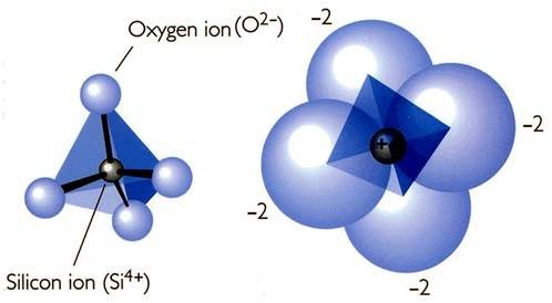

  • #36
dragoneyes001 said:
wouldn't being in a molten state have allowed the oxygen to escape from the iron?
Most of the oxygen in rocks is combined with silicon to form silicate tetrahedra:
When a silicate rock partially melts, it's usually these silicate tetrahedra the crystal structure breaks into, and it's not a high-energy enough environment to separate the oxygen from the silicon.
Note that "oxidised" doesn't just mean "combined with oxygen" also! I was thinking more along the lines of iron-containing silicate minerals like olivine and pyroxene than pure iron oxide. I think iron oxide would decompose upon heating and release the oxygen (someone correct me if I'm wrong!) but the silicate minerals would decompose into tetrahedra like that one. Notice the oxygen ions give the structure an overall negative charge, so positive iron (and magnesium and other metal) ions can form ionically-bonded minerals like olivine and pyroxene out of these tetrahedra in different arrangements:
(Image source: http://www.earth.lsa.umich.edu/earth118/figure-03-11-2.jpg)
  • #37
this helps explain why so much gold is found around quarts
