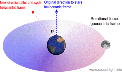

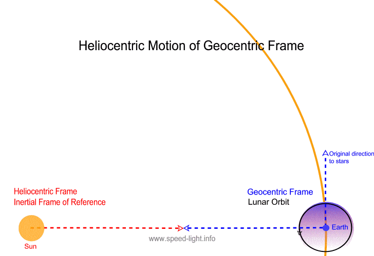

I post this question because i read the following:
As we can see, a revolution of Earth-Moon system around the Sun for 1 synodic month is equivalent to an arc of 27° of the terrestrial orbit around the Sun. This angle (27°) is the same as the one between Moon-position at 1 sideral month and at 1 synodic month according to Earth's frame of reference.
The vector "E" (beginning from the Moon) perpendicular to the segment Earth-Sun points to a different direction every synodic month.
Thus from this "triangle" of vectors, we can calculate mean Moon's speed E' around Earth without Sun's gravitionnal influence.
ll E ll=square root [ (E sin phi)² + (E')² ]
thus ll E' ll= ll E ll * cosine phi
ll E' ll= current Moon's speed * cosine phi
ll E' ll= 3680km/hour * cosine 27°
ll E' ll=3279 km/hour
THUS: In an isolated Earth-Moon system, Moon would run at a mean speed of 3279 km/hour around our planet.
I agree with the value of phi, but is this method to calculate Moon's speed in an isolated Earth correct?
thank you
I took a look at that website, and wouldn't consider anything on it to be reliable.

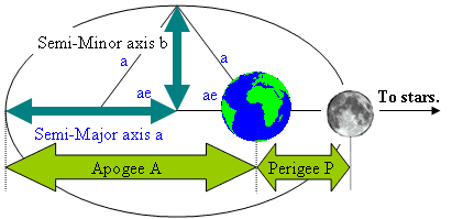

A website states that if Sun's gravitationnal effect were "put off", Moon's orbit around the Earth would be almost a perfect circle (whereas with the Sun it's an ellipse).
In that condition, would the mean moon's speed become equal to V= 3680*(1-2e) where "e" is the actual excentricity of Moon (about 0.05) and "2e" the variation ratio, as they suggest?
[PLAIN]http://img40.imageshack.us/img40/9568/1dtp.jpg
thank you

Termina, that is not true. First of all, a two-body system acting via gravity NATURALLY is elliptical (or hyperbolic). The sun is not responsible for the Moon's elliptical orbit.

The Earth-Moon system by itself would almost exactly follow an elliptical orbit. (the only deviation is due to general relativity, which in the case of the slow-moving Moon around the not-so massive Earth is negligible). Call this period T', to distinguish it from the period where the Sun is present.
T' = 2\pi\,\sqrt{\frac{a^3}{G(M_e+M_m)}
where a is the semi-major axis of the orbit of the Earth and Moon about their center of mass, G is the universal gravitational constant, and Me and M[/sub]m[/sub] are the masses of the Earth and Moon. Rather than using G and the masses of the Earth and Moon, all of which suffer from a lack of accuracy, it is far better to use the Earth gravitational coefficient and the Moon/Earth mass ratio:
G(M_e+M_m) = GM_e(1+M_m/M_e) \approx 1.0123 \mu_e
where \mu_e = 398600.4418\pm0.0009\,\text{km}^3/\text{s}^2. The Moon/Earth mass ratio os 0.0123, to many places of accuracy. What to use for a? The French Ephemerides of the Earth, Moon, and Sun specifies a value of 384,7481[/color] km. The resulting value for T' is 0.4 minutes longer than the sidereal month; essentially no change.
This is consistent with lunar theory. What you are talking about is the variation of the Moon. This has a period term and a secular term. The secular term is exceeding small, measured in arcseconds/century. The affect of the Sun on the period of the Moon, and hence on the distance traveled, is essentially null.--------------------------
1[/color]A widely-used value for the Moon's semi-major axis is 384,399 km. This is not the semi-major axis. It is instead the inverse of the mean of the inverse of the distance. Using that value yields a period that is about 53 minutes shorter than the observed sidereal month. This says the Moon would, on average, move slightly faster than it does with the Sun present. This is counter to lunar orbit theory (essentially no effect), and in any case, it does not support termina's position.
