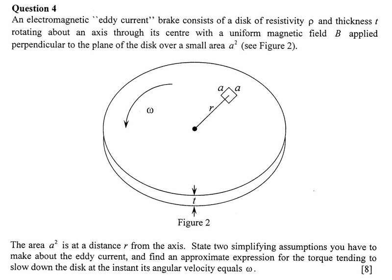

As given in the picture.
So this is what i have done.
I calculated:
\frac{d\phi}{dt} = B \pi b^2 *\frac{\omega}{2\pi} = e.m.f.
R = \frac{\rho a}{at}
Thus, I = emf/R = \frac{ar \omega t}{\rho}
Sub in I into F = BIL taking L as a.
But i have a feeling that this is wrong, cause the working is too simple.
Any help will be greatly appreciated.
