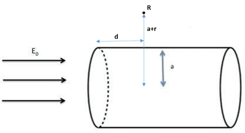

What I am interested in is the electric field at a point R which is d distance along z - direction and r distance away from its surface (attached is a sketch for better understanding of the scenario). Would you be able to help me in deriving an expression?
Could you recommend me a textbook to look for? I referred Griffiths and many other books, but they all consider the case where E field is perpendicular to the axis of the cylinder.
Appreciate your support very much.

@DNN An exact solution is quite difficult. The approximation can be made that ## \vec{P}=\chi \epsilon_o \vec{E}_o ##, (where ## \vec{E}_o ## is the applied electric field), and that ## \vec{P} ## is uniform everywhere inside the cylinder. ## \\ ## (This is different from the OP's assumption, where he used a continuous ## \vec{D} ## across the endfaces, and that ## \vec{D}_{external}=\epsilon_o \vec{E}_o ##. (The second part of this is where my solution differs the most from the OP's. Because I'm working under somewhat of an approximation, I may not have ## \vec{D} ## precisely continuous across the endface. I'm basically assuming that the depoarizing ## \vec{E}_p ## from the endfaces can be ignored in computing ## \vec{P} ##)). ## \\ ## This approximation that I'm making here can be reasonably good, especially if the cylinder is reasonably long, e.g. a length ## L>4d ##, and/or if ## \chi << 1 ##. (The dielectric constant ## \epsilon=\epsilon_o \epsilon_r =\epsilon_o(1 +\chi) ##). Under this assumption of uniform ## \vec{P} ##, ## -\nabla \cdot \vec{P}=\rho_p=0 ##, (where ## \rho_p ## is the polarization charge density), and the only polarization charge occurs on the endfaces, where surface polarization charge density ## \sigma_p =\vec{P} \cdot \hat{n} ##. That will make ## \sigma_p=\pm P ## on the endfaces. Besides the applied ## \vec{E}_o ##, this is the only source of electric field in this problem. (Again, we made an approximation that ## \vec{P} ## is perfectly uniform, but under this approximation, this is the result). ## \\ ## These endfaces that have area ## A ## will have total charge ## Q_p=\pm PA ##. Up close to the endface, it looks like an infinite sheet of electric surface charge. Somewhat distant from the endface, you can simply write Coulomb's inverse square law: ## \vec{E}_{endface}(\vec{r})=\frac{Q_p}{4 \pi \epsilon_o |\vec{r}-\vec{r}'|^3}(\vec{r}-\vec{r}') ## , where ## \vec{r}' ## is the coordinate of the center of the one endface (remember there are two of them) . ## \vec{E}(\vec{r})_{total}=\vec{E}_o+\vec{E}_{endfaces} ##.

So, under this argument, if the point R is located right above the middle of the cylinder (z coordinate is L/2),
E(r)total = Eo ?

I presume you are putting the base at ## z=0 ## and the top of the cylinder at ## z=L ##. There is a ##" +" ## surface charge density at ## z=L ## of ## \sigma_p=P ## and a ##"-"## surface charge density ## \sigma_p=-P ## at ## z=0 ##. It is somewhat objective whether to include their effect inside the cylinder, e.g. at ## z=\frac{L}{2} ##. For a long cylinder, and/or small ## \chi ##, the effect of ## \vec{E}_p ## will be minimal at ## z=\frac{L}{2} ##. ## \\ ## If their effect is included in ## \vec{E}_{total} ## then you get a ## \vec{P} ## that is no longer uniform, if you assume ## \vec{P}=\epsilon_o \chi \vec{E}_{total} ##. ## \\ ## That non-uniform ## \vec{P} ## will likely generate some internal polarization charge density ## -\nabla \cdot \vec{P}=\rho_p ## that will be the source of additional electric field. In general, I don't think there is a closed form mathematical solution to solve this, and very refined numerical methods would have a "first guess" ## \vec{E} ##, and compute ## \vec{P}(\vec{r}) ## everywhere, and then compute any additional ## \vec{E}_p ## that results, etc., in a rather difficult iterative process to try to get a complete ## \vec{E}_{total} ## and ## \vec{P} ## that is self-consistent=i.e. that it satisfies ## \vec{P}=\epsilon_o \chi \vec{E} ## everywhere. The dielectric cylinder of finite length in a uniform electric field does not have an exact closed-form solution.
