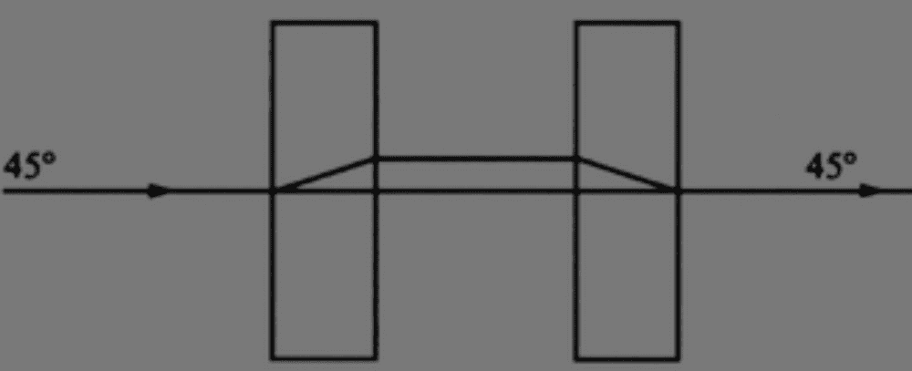

Does inserting an analyzer loop in the EPR experiment with photons affect the non-local correlation in this experiment?
Given an EPR experiment such as the Alain Aspect 1982 test of non-locality using photons; if you modified the experiment so that the entangled photons first go through a analyzer loop (polarizer + inverse polarizer) before going to the polarizers in the experiment would you still see a non-local correlation between the entangled photons in this experiment?
A loop analyzer is a polarizer and its inverse polarizer that does not change the polarization as show in the following diagram:

"It would" what? I did a first read through the thought experiment you posted and my understanding is that an analyzer loop that looks like:
Schematic of a box with a horizontal arrow entering from the left, an elliptical loop inside, a label x above the box and a label y below it, and a short line exiting on the right.
has no effect on the outcome and you still get the Bell violation whether it is there or not. Am I misunderstanding?

Sorry, I wasn't clear: "Would you still see a non-local correlation between the entangled photons in this experiment?"
Yes, you would. The only issue is that I am not aware of an experimental demonstration of this. But maybe someone else knows... :smile: and I would love to see that.
