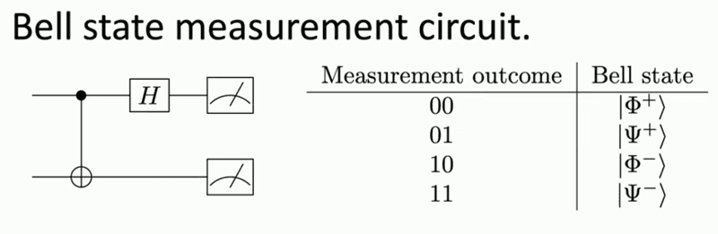

DrChinese said:
A) introducing a time delay, as was done in the experiment, does not change which detectors are triggered. there is no change to the interaction with the environment whatsoever. What you end up with is an indication of which Bell State would’ve been selected if one had been created.
It's the significance of the detector trigger that is changed. To illustrate this, consider an abstract bell measurement circuit involving a CNOT (CN) state, a Hadamard (H) gate, and spin-z measurements (M)
We can see that a preparation ##|\Phi^+\rangle## will yield $$|\Phi^+\rangle \xrightarrow[\text{CN}]{} \frac{1}{\sqrt{2}}\left(|0\rangle+|1\rangle\right)|0\rangle\xrightarrow[\text{H}]{}|00\rangle\xrightarrow[\text{M}]{} M_{00}$$I.e. Repeated experimental runs will yield 0,0 100% of the time. Similarly, the preparation ##|\Phi^-\rangle## will yield 1,0 100% of the time. Now lets say we intervene between preparation and measurement such that, whether or not the preparation was ##|\Phi^+\rangle## or ##|\Phi^-\rangle##, we now have $$\frac{1}{2}\left(|\Phi^+\rangle\langle\Phi^+|+|\Phi^-\rangle\langle\Phi^-|\right) = \frac{1}{2}\left(|00\rangle\langle00|+|11\rangle\langle11|\right)$$as an "intermediate" preparation. Now we have the evolution $$\frac{1}{2}\left(|00\rangle\langle00|+|11\rangle\langle11|\right)\xrightarrow[\text{CN}]{}\frac{1}{2}\left(|00\rangle\langle00|+|10\rangle\langle10|\right)\xrightarrow[\text{H}]{}\frac{1}{2}\left(|00\rangle\langle00|+|10\rangle\langle10|\right)\xrightarrow[\text{M}]{}\frac{1}{2}\left(M_{00}+M_{10}\right)$$You can see that approx. half our experimental runs will trigger a result 0,0 and the other half 1,0. But we can't naively divide our ensemble into two subensembles and say "these 0,0 runs would have been 0,0 even if we didn't intervene"
I suspect something similar (but not identical) is happening in the actual experimental setup. Distinguishing photons leaves the phase undefined, and so instead of inferring a bell state from detectors, a mixed "correlated" state is inferred.
*I invite other people to double check this math, but I think the conclusion holds. If we do not have phase information, we cannot infer a bell state from a set of detector outcomes.
[edit] - fixed math
[edit 2] - I think the above is still a little bit hand wavey. My interpretation of the paper is, when indistinguishability is maintained, the photons are projected onto a one of two bell states depending on whether the detector results are correlated or anti-correlated. If distinguishability is established, then the photons are projected onto a mixed state whether or not the detector results are correlated or anti-correlated. The above look at an abstract circuit maybe hints at why but doesn't fully explain why. I will have to try to understand the minutia of the particular experiment.
[edit 3] - Rewrote to try and make the relevance more concrete

  • #90
We can see that an input ##|\Phi^+\rangle## will yield $$|\Phi^+\rangle \xrightarrow[\text{CN}]{} \frac{1}{\sqrt{2}}\left(|0\rangle+|1\rangle\right)|0\rangle\xrightarrow[\text{H}]{}|00\rangle\xrightarrow[\text{M}]{} M_{00}$$I.e. We infer a bell state from the reading 00. But now lets say our input is the state $$\frac{1}{2}\left(|\Phi^+\rangle\langle\Phi^+|+|\Phi^-\rangle\langle\Phi^-|\right) = \frac{1}{2}\left(|00\rangle\langle00|+|11\rangle\langle11|\right)$$Now we have the evolution
$$\frac{1}{2}\left(|00\rangle\langle00|+|11\rangle\langle11|\right)\xrightarrow[\text{CN}]{}\frac{1}{2}\left(|00\rangle\langle00|+|10\rangle\langle10|\right)\xrightarrow[\text{H}]{}\frac{1}{2}\left(|00\rangle\langle00|+|10\rangle\langle10|\right)\xrightarrow[\text{M}]{}\frac{1}{2}\left(M_{00}+M_{10}\right)$$You can see that a mixed state has a 50/50 chance of triggering a detector result 00.
I agree with all of the above.
Morbert said:
And so we are not automatically justified in inferring a Bell state from the same detector outcomes.* I suspect something similar (but not identical) is happening in the actual experimental setup. Distinguishing photons leaves the phase undefined, and so instead of inferring a bell state from detectors, a mixed "correlated" state is inferred.
You have it backwards though! If there is no Bell state, there is no swap. Phase information is perfectly available but not meaningful when a swap does not occur. That because the 1,2 pair does not develop a relationship with the 3,4 pair.
But for those of you out there that don’t believe anything physical happens at the 2,3 measurement that creates the 1,4 entanglement: what difference would that make? As I indicated, the detectors indicate Reflect/Transmit at the projecting splitter and the polarization. What you call phase is simply part and parcel of those same properties.
Seen another way: tell me what happens to 1,4 as a result of a successful swap where the 2,3 photons come close to each other - as opposed to when a delay is introduced and no swap occurs. The coincidence time window has most 2,3 photons detected within 3 ns and usually 1 ns apart. 1 ns is about 1 foot. So they do not precisely overlap. Further, orthogonal photons cannot interact (and that happens in 1/2 the cases). So explain what is different when a delay is inserted to change any readings when our experimenter flips his swap/no swap switch.
Or accept the conclusion of the paper: In conclusion, we have demonstrated quantum entanglement between two photons that do not share coexistence. … This is a manifestation of the non-locality of quantum mechanics not only in space, but also in time.
