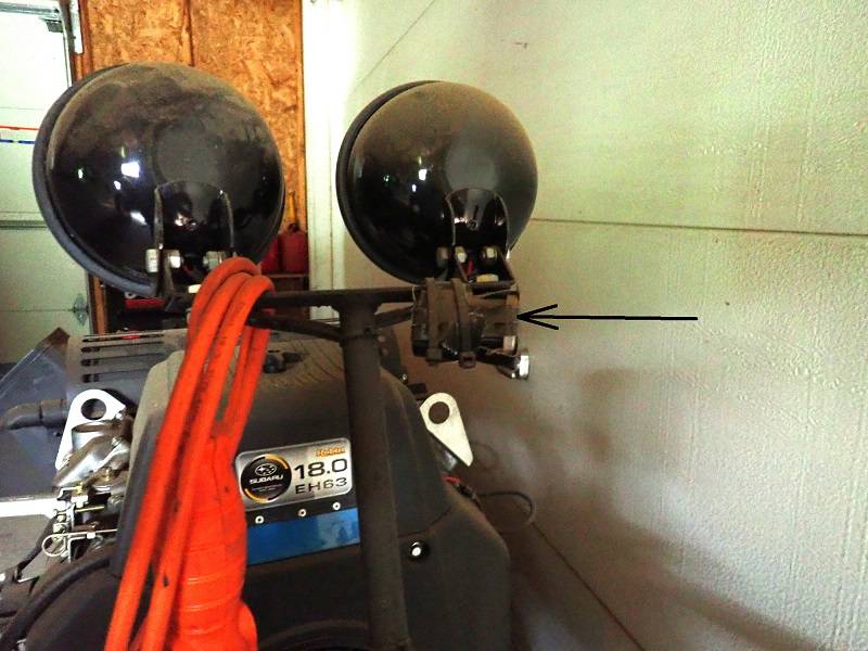

If you have many pieces of cargo, say a few dozen rocks, bouncing around, the calculations are different. This is particle impact damping (search the term). It will also add to the power to drive the truck.
Particle impact dampers are used to control vibration. The basic principle is that anything that dissipates energy from the vibration of a vibrating system will reduce that vibration. The photo below shows a particle impact damper on the light bar of my hot rod snowblower:
The light bar had a bad torsional vibration about the vertical axis when the engine was at idle speed. Adding the particle impact damper reduced the vibration by a factor of several times. The damper is the 35 mm film container half filled with lead shot, wrapped in duct tape, and tie wrapped to the light bar at the arrow. If you want to see this snowblower in operation, search youtube hot rod snowblower hydrostatic. It has a hydrostatic transmission, so can be quickly run back and forth.
Wait, what? Your hot rod snowblower doesn't appear to have any aero mods yet... WTH? :wink:
Well, um, err, actually I partly disassembled it to build an improved machine. This machine is clumsy to use, and only moves about 60% more snow than my 32" 10 hp Ariens. The limiter is impeller capacity, not power. My improved version will have two impellers and eliminate the auger to make a machine that moves even more snow, and will be physically smaller than my Ariens. That's if I ever get off my lazy butt and actually work on it.
Well, it's the middle of the hot summer, so I can see how the motivation to work on the snowblower would be low right now. :smile:
