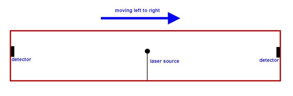

Suppose there is a rectangular box moving straight in space at constant velocity of say 150000000 m/s. In other words, it's an inertial frame of reference for anyone inside the box. The length of box is 600000000 meters. The width and height are not really important here so you can suppose any reasonable values for them. Please note that the speed in light i vacuum is taken to be 300000000 m/s.
I can understand that why the propagation of any wave which requires a medium, such as sound, is not affected by the uniform motion of box in space. For example, if you have two sensors at the opposite ends of box and a sound is produced in the middle of box, both sensors would register the same time when the sound wave reaches them.
Light does not need any medium to propagate. Suppose a laser pulse of an infinitesimal duration is produced in both directions. It is also assumed that the pulse does not undergo any diffraction - the pulse remains collimated. In my opinion, if it was an absolute rest inertial frame of reference, both pulses would hit the sensors at the time. The pulses would reach the sensors/detectors after one second because laser source is in the middle - 300000000 meters from both ends. I know what I'm saying is wrong because there doesn't exist any absolute rest frame of reference.
But this is the point which is troubling me. I suspect that even for the given frame of reference which is moving at constant velocity of 150000000 m/s in space, the sensors would still detect the same time for the arrival of pulses but I don't understand why and how.
If the box is moving from left to right, then the left detector would have moved 150000000 meters toward the light pulse therefore the left detector should register pulse arrival first; after 0.5 second. On the other hand, the right detector would have actually moved away from the pulse. The right detector would register the arrival after 1 second.
Where am I going wrong?

PainterGuy said:
Hi,
I wanted to understand it a little better before I respond to any of the replies. I was working on it today but came across a point which I couldn't understand. I'd really appreciate if you could guide me. Thank you.
For anyone at rest with respect to the box the light pulses would hit the detectors at the same time. For someone for which the box is moving from left to right, the light hits the left detector first and then the right detector
We are back to the relativity of simultaneity.
Yes, Sir, you are right but, to me, the situation is somewhat different.

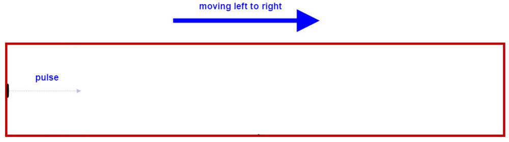

Let me change the version to explain myself. Suppose instead of the detectors there are reflectors. Once the pulse hits reflector, it reflects back to the person who is also standing in the middle. Yes, in such a case, the person would SEE/OBSERVE both pulses reaching his eyes at the same time. From my earlier statement, when the left reflector moves 150000000 meters toward the pulse, at the same time the observer moves away 150000000 meters toward the right so the effect gets cancelled. I hope you can understand what I'm trying to say. I already had this point in mind when I made my previous posting and that was the reason I employed detectors instead of reflectors.
The detectors are only there to register the arrival time of pulses. In other words, repeating what I said earlier in previous positing, one detector would register the pulse 0.5 seconds before the other.
Could you please guide me with this? Thanks.
Yes. Now work out how this whole process looks to an observer watching the ship go by from left to right at half the speed of light. As @Janus has told you, that observer will see the light pulse hitting the left mirror first. But he will also see that pulse take longer to get back to the person in the center of the ship, because that person is moving to the right and so is the reflected pulse. And the observer watching the ship go by will see the light pulse hitting the right mirror second, but he will also see that pulse not take as long to get back to the person at the center of the ship, because that reflected pulse is moving to the left and the person is moving to the right. So in the end that observer will agree that both pulses return to the person in the center of the ship at the same time.
"The arrival time of pulses" registered by the detectors depends on how their clocks are synchronized. And so that time does not tell you any "absolute time". It only tells you the time according to one particular way of synchronizing clocks. You have specified that the detector clocks are synchronized according to the time in the inertial frame in which the ship is at rest. So that's the "time" the detectors will show. See below.
No, it wouldn't. Both detectors would register the same time, because you specified that the detector clocks are synchronized according to the ship's rest frame.
The observer watching the ship go by from left to right at half the speed of light will calculate that the times according to his rest frame, in which the ship is moving left to right at half the speed of light, are different: the time according to his rest frame for the pulse hitting the left detector is earlier than the time according to his rest frame for the pulse hitting the right detector. But he will not claim, based on this calculation, that the detector clocks themselves will register these times. He knows they won't, because he knows that the detector clocks are not synchronized according to his rest frame.

I'm really sorry but I cannot still understand where I'm going wrong. Both detectors are in the same frame of reference so I don't even understand what it has to do with the synchronization of clocks. Both clocks would be affected by the same time dilation because they both are on the same ship (or, box) and should read the same time. Or, perhaps, the clock/detector situated toward the direction of motion, i.e. right detector, gets affected by time dilation more than the left detector. The ship is moving from left to right.
If two persons are located on the same ship moving at uniform speed, their watches would tell the same time. Yes, for accuracy, they could use atomic clock watches.
As I said earlier, if it was any other wave requiring a medium for propagation, then both detectors should register the same time of arrival. But light doesn't require a medium.
No. Both detectors are at rest relative to each other, and to the person in the center of the ship. That does not mean they are "in" one particular frame of reference. You can use any frame of reference you like to describe them and their motion. They are "in" all frames of reference. They just aren't at rest in all of them; they're only at rest in one.
Because synchronization of clocks determines what readings the clocks will register at particular events. The detector clocks being synchronized in the rest frame of the ship (which is also their own rest frame) means that if the person at the center of the ship, equidistant from the two detectors, sends out two light pulses at the same instant, one towards each detector, the two detector clocks will register the same reading when they receive the pulses. Each detector receiving a pulse is an event: it's a direct physical happening. And so is the detector's clock registering a particular reading--meaning showing a particular arrangement of hands on its face or a particular set of digits on its display, depending on what kind of clock it is. You can't change what happens at particular events by changing reference frames, so all reference frames must agree on what readings the two detector clocks display when the pulses reach them.
Not according to the ship and the person in the ship. To the person in the ship, the detector clocks, which are at rest relative to him, are not time dilated at all. It is the clocks belonging to the observer watching the ship go by that are dilated according to the person in the ship.
Nope.
Yes. And the same applies to two detectors at opposite ends of the same ship, all at rest relative to the ship.
This whole line of thought is a red herring. You should forget all about it.
Unless you state, or otherwise imply, what it's moving with respect to, this statement is meaningless.
PainterGuy said:
Thank you.
You still aren't getting the gist of the relativity of simultaneity.
You have three clocks in a row with one halfway between the other two. It emits a light pulse which is reflected back to it.
For these clocks and anyone at rest with respect to them, this is what occurs.
(while there appears to be a slight delay before the light pulse is reflected, that is just because you don't see the reflected pulses until they clear the clocks.)
Here we assume that the clocks are all synchronized in this frame. The first pulse leaves the middle clock when all the clocks read the same strikes the two clocks simultaneously wile all the clocks read the same, and is reflected back to return to the central clock while all three clocks read the same.
Now the same clocks, and same light pulses, with the difference that the clock have a relative motion with respect to the frame we are examining the events from.
The first light pulse leaves the center clock when it reads the same time as in the first animation. The clocks and the distance between them is length contracted and all three clocks are time dilated by the same amount. The left clock runs into the pulse first, and then it catches up with the right clock. The light leaves the central clock when it reads the same as it did in the first animation. Both the left and right clocks show the same readings as they did in the first animation when the light reaches them. However, these means that they do not at any time read the same time at the same time. The reflected pulses leave the left clock first, but still arrive at the central clock at the same time (and the central clock's reading of the time of this event agrees with the first animation.)
Thus for this frame the three clocks are never in sync. They tick at the same rate, but the left clock always leads the central clock and the right clocks always lags.
It doesn't matter whether you consider the three clocks as moving or the observer in the second animation.
If you were to give the observer in the second animation an identical set up of clocks, he would determine that his clock were all in sync. However, an observer at rest with respect to the first set of clocks would say that the other observer's clocks as being out of sync.
This is not a matter of one of the observer's view be the "right" one, while the other view is "illusion" either. Both observer's version of "reality" is equally valid.

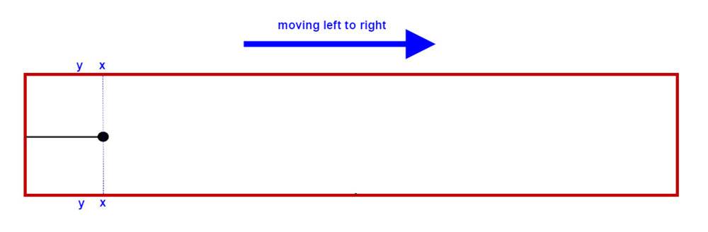

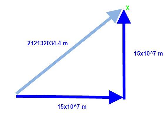

I have another related question. I'm going to use a variation of my earlier statement from post #64.
Suppose there is a rectangular ship moving straight in space at constant velocity of say 150000000 m/s relative to another inertial frame of reference. In other words, it's an inertial frame of reference for anyone inside the box. The length of ship is 600000000 meters (two times the distance traveled by light in one second).
Suppose the width and height are both 300000000 meters. Please note that the speed of light in vacuum is taken to be 300000000 m/s.
Suppose a laser pulse of an infinitesimal duration is produced widthwise or heightwise in both directions by a source which is located in the middle. Please have a look on the attachment. In my opinion, if it was an absolute rest inertial frame of reference, both pulses would hit the marks labelled 'x'.
Would the pulse hit the mark x or y? I think it should hit the mark labelled y because the ship is moving toward the right and as the pulse takes some time to get to the mark, the mark would have moved. I hope you get the point.
If you say that the pulse should hit mark x then wouldn't it imply that the speed of ship add a rightward speed component to the light?
Thanks a lot!
PS: Edited after @PeterDonis pointed out the the error.
There is no such thing. You are not going to get anywhere if you keep trying to use concepts that simply aren't valid in relativity. You can reason to valid conclusions from invalid premises.
x
PainterGuy said:
If you say that the pulse should hit mark y
I assume you mean "if you say that the pulse should hit mark x" here.
In the frame in which the ship as a whole is moving to the right, the light pulses also will move to the right, as well as up or down. But this doesn't change the speed of the light pulses; it only changes their direction. Velocity vectors don't add in relativity the way they do in Newtonian physics.
You are taking a lot of time and effort over very basic SR problems that are treated in many SR textbooks. Have you tried to work through a basic SR textbook, such as Taylor & Wheeler's Spacetime Physics? If you haven't, you might want to try it.
Also, the setup you are describing in your latest post is basically a light clock with the light pulses moving perpendicular to the direction of relative motion of the clock and the observer. (All you would need to do would be to put a mirror at point x in the ship to reflect the light pulse back.) You should be able to find plenty of resources online that analyze light clocks (including a number of previous threads here on PF).

As for:
While it true, that from this "other" frame of reference the light has to travel a longer diagonal path to hit the "x", its speed along that path remains c.
So, for example, let's say that the "height" of the box is 0.149896229 m, and there is a mirror at "x". For someone at rest with respect to the box, the pulse travels straight up to x and reflects straight back, taking 1 nanosecond for the entire trip. For the inertial frame with a 0.5c relative velocity to the box, the pulse has to travel on a diagonal for both legs at c, and takes ~1.155 nanoseconds to return to the emitter.
If we were to increase the relative velocity between the two to 0.866c, you get a 2 to 1 ratio, like this:
Here we give both frames their own light clock. The light clock that is at rest with the animation frame ticks twice while the "moving" clock ticks once. The red numbers tick off nanoseconds. The expanding circle shows how both pulses travel at c with respect to the frame of reference.
If we switch frames to one in which the "moving" clock is at rest with respect to the animation, it would be the one ticking off 2 nanoseconds for every 1 nanosecond ticked off by the other clock. Note that we change nothing concerning the motion of the light clocks themselves, we just switched to view where the clock shown moving to the right stays at the middle of the animation, and the other clock moves off to the left.

@Janus, thank you for your post.
In other words, from an observer's perspective aboard the ship, the light only takes 0.5 seconds to get to mark x because the person in the ship only sees light traveling the distance of 15x10^7 m or '0.5c' sec.
From outside the ship a stationary observer would say that the light should take 0.70712 seconds because it has the distance of 212132034.4 meter to cover. Therefore, the stationary observer concludes that the ship's clock is running slow.

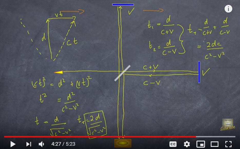

I have a related question about Michelson Morley experiment.
Why is the length contraction really necessary to explain Michelson Morley experiment result? I understand that Lorentz came up with the length contraction hypothesis to save the aether theory. (I have some questions about Lorenz aether theory but it'd better to start a separate thread for that.) The problem with me is that I don't think that the experiment needs any length contraction or any relativity related explanation; simple Newtonian explanation should work fine when no aether is assumed.
In the experiment the following times were calculated where 'c' is speed of light, 'v' is orbiting speed of Earth around the sun, and 'd' is length of both arms.
t_total_1 for longitudinal arm = 2dc/(c^2 - v^2)
t_total_2 for transverse arm = 2d/sqrt(c^2 - v^2)
From the equation, it could be seen that t_total_1 would be greater than t_total_2.
Earth is an inertial frame of reference therefore if "v" is removed, we are left with t_total_1=t_total_2. In my view, the aether was the only reason "v" was introduced in the equation. It was assumed that the distance along the direction of longitudinal mirror would take larger time because

PainterGuy said:
Would it be wrong to say that the motion of ship adds a horizontal component (in direction of motion) to the speed of light from reference frame of stationary observer outside the ship?
Not the way you mean. As I said before, velocities don't add in SR the way they do in Newtonian physics. The speed of light is always c, in every frame. The observer sees the light beam inside the ship moving at c in his frame. He sees it moving in a different direction, in his frame, than the ship observer does in the ship frame. But both of them see the speed of the light as the same: c.
The Michelson–Morley experiment is consistent with the Emission Theory, but that theory is disproven by other observations:
https://en.wikipedia.org/wiki/Emission_theory

View attachment 257691Continuing from post #72.
Would it be wrong to say that the motion of ship adds a horizontal component (in direction of motion) to the speed of light from reference frame of stationary observer outside the ship? Repeating it: Suppose there is a rectangular ship moving straight in space at constant velocity of say 150000000 m/s relative to another inertial frame of reference. The length of ship is 600000000 meters (two times the distance traveled by light in one second). If light pulse is produced horizontally in direction of ship's motion then for a stationary observer outside the ship sees the pulse covering distance of 'c' sec +'0.5c' sec='1.5c' sec (m/s * sec = m) but for stationary observer it takes 1.5 seconds and stationary observer would also notice that the ship observer has the clock running slow therefore for the same distance of '1.5c' sec, the ship clock ticks only 1 second and hence the ship observer would observe the pulse moving at the speed of light.
The pulse would take 4 sec according to the "stationary" observer to go from left to right end, if we assume no length contraction of the ship. The pulse moves at c, the right end has a "head start" of 2 light sec, and move to the right at 0.5c
It would take 1 1/3 sec for the pulse to go back from right end to return to the source, total round trip time 5 1/3 second. For someone in the box, the pulse takes 2 sec each way, for a round trip time of 4 sec.
At 0.5 c, the time dilation would have a clock in the box tick 0.866 as fast according to stationary observer, 0.866 times 5.33 = 4.62 seconds, not 4 seconds. The box observer and "stationary observer would disagree as to how much time ticked away for the Box clock.
If we go back to the light clock example and add a second light clock that is parallel to the line of travel, then you get this without length contraction. The horizontal pulse doesn't even reach the mirror before the vertical pulse has made a round trip. But if I am traveling with that rightward moving clock, I would measure both pulses taking equal times to make their round trips.
But if we add length contraction, then according to the "stationary" observer, the box is only 1.732 light sec long. The pulse moving to the right takes 3.464 sec to reach the right end, and going the other way ~1.1547 sec. Total round trip time is ~4.619 sec. It still takes 4 secs round trip according to the the box observer.
0.866 times 4.619 = 4 sec (allowing for rounding). Box and "stationary" observer agree as to how much time ticks off for the box clock.
Adding length contraction to our light clock set up gives:
If we place clocks at the both ends of the box, and synchronized according to the box frame, if the pulse leaves the left end when the clock reads 12:00:00, it will reach the right end when the clock there( and thus both clocks) reads 12:00:02
The stationary observer has to agree to this: light leaves left clock when it reads 12:00:00 and arrives at right clock when that clock reads 12:00:00
But we also know that it takes 3.464 sec for the pulse to traverse from end to end of the box according to the stationary observer. Due to time dilation he will measure both clocks as ticking off 3 sec during that time. thus for the right clock to read 12:00:02 when the pulse arrives, the right clock had to read 11:59:59 when the pulse left the other end. According the stationary observer, the right clock lags 1 sec behind the left clock, while according to the box observer, the two clocks always read the same.
I'm grateful of you. I'm sorry but I needed to confirm something. Did you mean to say "arrives at right clock when that clock reads 12:00:02"?
According to the stationary observer outside the ship, "it takes 3.464 sec". It's 3 seconds from 11:59:59 to 12:00:02 so how do we account for the remaining "0.464" portion of second?
As already explained, that experiment alone doesn't imply relativity. But you need a theory that explains all experiments.
