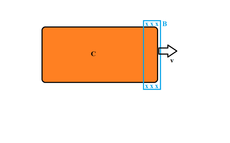

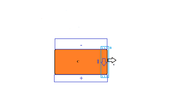

Given the following diagram:
Diagram of a rectangular orange conductor labelled C moving right at velocity v, partly inside a blue-outlined region marked with inward-pointing crosses labelled B, representing a uniform magnetic field.
The conductor(C) of known volume(##V##) and resistance(##R##), passes a uniform magnetic field(##B##)at a constant velocity(##v##), via the following formula: ## \epsilon = -vBL## the induced EMF can be calculated. This conductor acts as a power source to a certain circuit,therefore, it's connected to a circuit(which I chose not to include in the diagrams because I am focusing on this conductor specifically) to distinguish the resistances I'd like to label ##R## as the internal resistance of the power source( that is the conductor) and r as the resistance of the circuit.
I think the way of calculating the induced current here is simply Ohm's law:
##I = \frac{V}{R + r}##
the total resistance is it ##(r+R)##, not sure though...

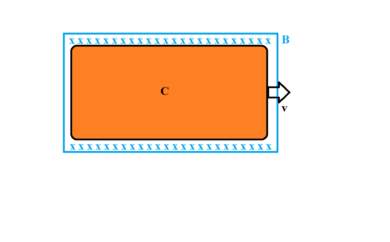

Now, the main point, what would be the effect of reducing the magnetic field span(Magnetic field span: the area the magnetic field covers at the same strength) like so:
Diagram of an orange rectangular conductor C moving right at velocity v, partly entering a blue-outlined region marked with x symbols representing a uniform magnetic field B pointing into the page.
While ##L##, ##v## , and ##B## are all the same? My assumption: that the induced EMF is the same, however, the second diagram/version would induced a lower current? But why...?
It makes no sense to me that the the currents would be the same magnitude, it does in-terms of EMF because of all the variables in the motional EMF formula are the same.

Hey there!
No reply yet huh? Well, I'm going to chime in then! Please take my comments with a grain of salt as I am here to discuss it with you rather than give you an answer (simply because I don't think I have one! I'm just bored at work o0)).
There are two things I am thinking about:
First,
With the first figure, there will be an applied voltage difference (or emf I should say) along the long sides of the moving conductor (all the way). For the second figure, there will only be a voltage difference (emf) at the part of the moving conductor that is with in the small magnetic field (only part of the long sides). For the second figure, this applied voltage (emf) will travel along the long sides of the moving conductor whereas for the first image it is set throughout the long sides. What do you think?
Second,

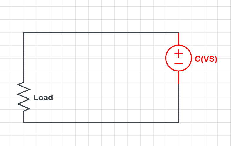

You say that this moving conductor is connected to a circuit. I think the circuit that you speak of is needed to determine the result. Specifically speaking I think the point where the contacts meet the moving conductor is important. What do you think?
If you get an answer please post!

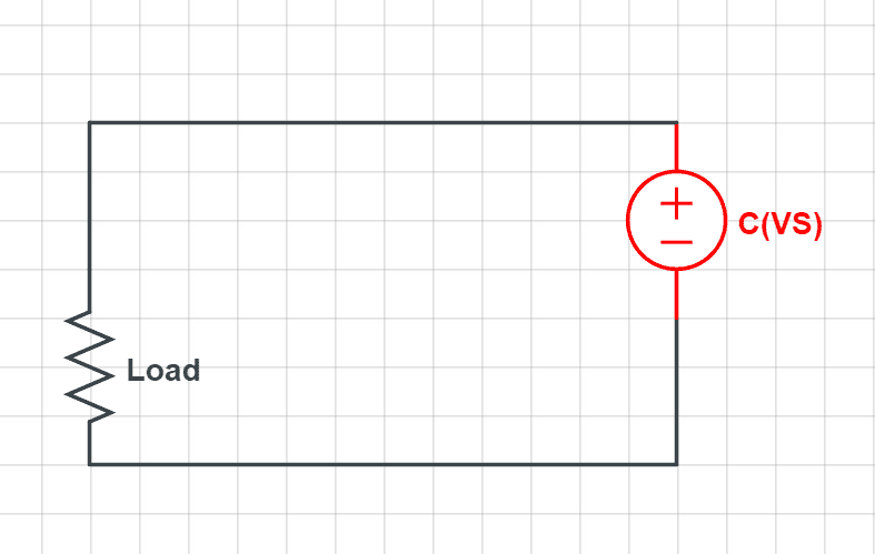

Hi there!
Well, you could simplify things, we could assume that the induced EMF is only along the side with respect to the magnetic field, which makes sense. However, since all the variables are the same(via motional EMF law) the induced EMF in both diagrams should be the same(with respect to ## v,B,L##). I think the induced current would not be equal, based on the point of the magnetic field span being smaller and the point you made too.
As for the circuit here is a simple diagram of it:
Circuit schematic of a closed loop with a resistor labeled Load on the left side and a voltage source labeled C(VS) with plus and minus terminals on the right side.
Where (C) is the conductor we're talking about.

Yes, I agree with you, current would increase when arranged as figure 1. I think this is because figure one can be thought of as multiple figure 2s in parallel (multiple emf sources connected in parallel). So i am think of it as comparing 1 battery (fig2) with n batteries connected in parallel (fig1). Fig1 and Fig2 will have the same emf, but since there are multiple "emf sources" in fig1 (as per my previous crude statement), they will provide more current (assuming the contact is all along the long sides of the conductor). I think that R (resistance of the conductor) changes according to the configuration (fig1 vs fig2). Maybe if you have resistivity (and you have the volume) you can calculate the resistance of the conductor?
Yes, hopefully Jim Hardy will swoop in for the save (or any PF vet for that matter).
That does make sense when we compare it to ta battery in parallel.

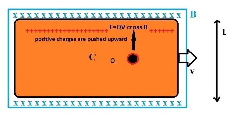

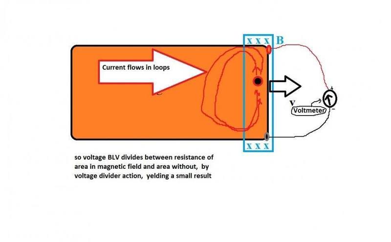

in what plane do you envision that length term L ?
Here's what i see for your first picture
Diagram of a conductor moving right at speed v through a magnetic field B marked by crosses pointing into the page; positive charges are pushed upward toward the top edge, with the force F = QV cross B shown on a charge Q and the length L marked vertically.
e = BLV , ignoring external circuit
sorry, i can't do the fancy script
and for your second picture
Diagram of an orange rectangular conductor with a block of X symbols marking a magnetic field region, red current loops drawn inside, a hollow arrow showing velocity v, and a voltmeter connected to the right edge; caption reads voltage BLV divides between resistance of area in magnetic field and area without.
point of connection for voltmeter leads is obviously significant.
Voltage across other end will be smaller.
So my initial
They way you see it it's correct.
Wait, is e = vBL is incorrect? I'm not sure as to how the voltage is divided up due to the total resistance of the conductor(area in/out of B).
I assumed from e = vBL they'd be the same considering all variables being equal(vBL). Therefore, there is no way for it to be indeed equal, hence reducing the magnetic field span does indeed reduce the induced voltage therefore induced current.

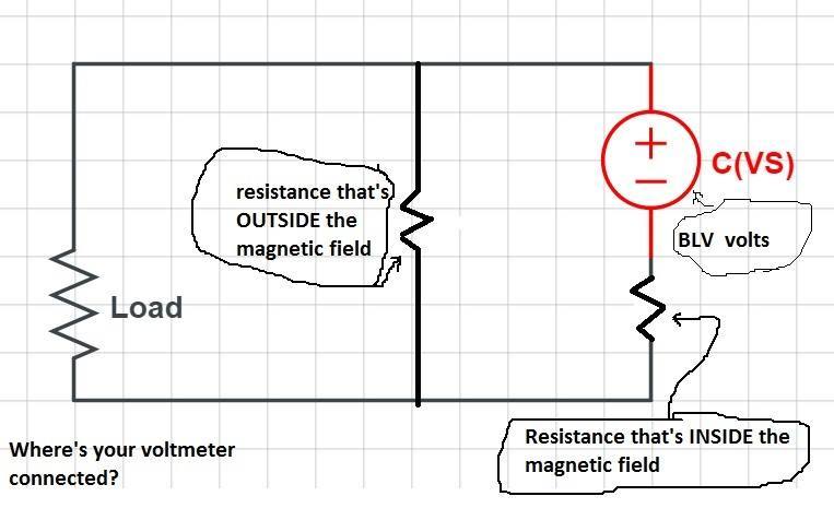

does it reduce induced voltage, or does it unblock parallel current paths as shown by the red lines ?
Thereby allowing Kirchoff to do his work ?
Circuit schematic of a homopolar-style generator: a load resistor on the left in parallel with a resistor labelled resistance outside the magnetic field, a voltage source marked C(VS) with BLV volts, and a series resistor labelled resistance inside the magnetic field; the text 'Where's your voltmeter connected?' appears at bottom left.
Voltmeter would be connected same area you initially labeled.
Would the formula now be:
##V_E * \frac{R}{R_O +R}##
Where ##V_E## is the induced EMF via (vBL) and R is the resistance of the portion inside the magnetic field ##R_O## portion of resistance outside the magnetic field?
While the first conductor's induced EMF is simply ##V_E##?
PhiowPhi said:
Where VEV_E is the induced EMF via (vBL) and R is the resistance of the portion inside the magnetic field ROR_O portion of resistance outside the magnetic field?
i think numerator would be ROutside the magnetic field
voltage divider action... KVL...
Yes, you're right on that one. I check back to the wiki of voltage dividers, ##Z_2## makes sense to be ##R_O##.

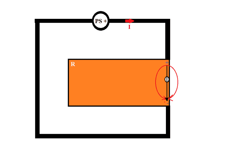

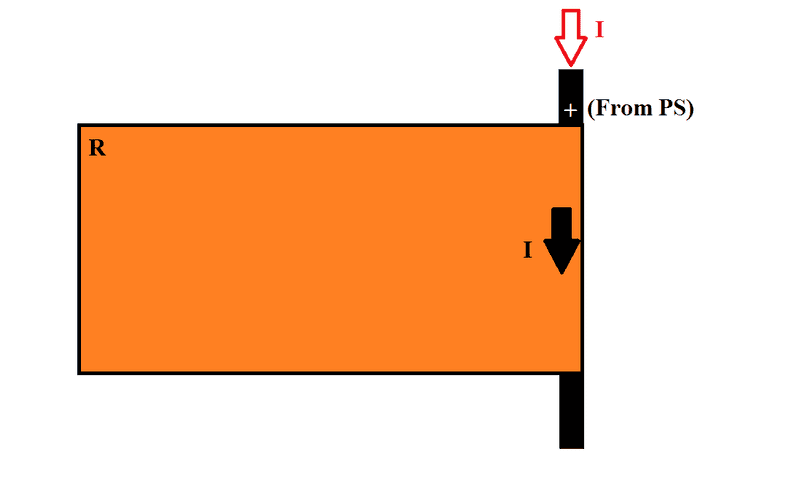

@jim hardy , something is bugging me with the topic of voltage dividers. Let consider a change in the model I presented.
Consider the same conductor. This time, exclude the magnetic field,motion and such. The induced EMF is from a power supply is connect to the conductor(C) a small portion of it like so:
Diagram of a rectangular orange conductive block labelled R, with a black lead on its top-right corner marked + (From PS) and a red arrow labelled I entering from above, and a black arrow labelled I leaving the block on the right side going downward.
Would current #I## flow all around the conductive region? Or just the part that it's connected to? Would the concept of voltage divider be applied here?
My assumption would say that the current would flow depending on the applied EMF polarity as diagram with the black arrow, but my gut feeling says otherwise, that it would flow in loops? Also, would the voltage divider still be valid? How would I apply it.
You're a mechanical, right ?
It's a field problem.
How would stress distribute over the area between those points of connection?
At any point in the orange rectangle there's a gradient between those points of connection.
voltage at any point will be in proportion to its relative distance from the two points of connection
and current will flow along the gradient lines, perpendicular to equipotential lines
eg a straight horizontal line bisecting the rectangle will be an equipotential line at V/2
the rest of the equipotential lines will be curves probably conic sections centered on the points of connection.
We solved such problems graphically in my day because we took that course before we'd taken vector calculus.
Draw your gradients...
or set up some equations

I remembered I posted this a while back, went there and reviewed it.
Here is my assumption after that brief review and studying about equipotential lines relative to this problem.
I adjusted the diagram here:
Sketch of a rectangular loop of thick black wire with a power supply labelled PS+ and current arrow I on the top wire, an orange rectangle labelled R inside, and a red circular field loop drawn around a vertical wire on the right side.
I think the most important line is the black one(where the majority of current will flow in that direction). Even though current flow's all around the conductor as other members clarified me earlier, however, I could risk it and say that 90% of the current flow will be on that line. What do you think? Of course experimenting would be best to prove this, and from that last discussion I wanted to test it, but it's quite messy to do haha
However, would current be equal ohms law? Should I consider the voltage being less due to the connection only being in a small part of the conductor?
Is voltage division something I need to consider too?
How did you arrive at 90 % ?Seems to me there'll be no current outside the conductor so i erased the right half of your red ellipse.
Seems to me your conductor can be imagined as an some finite number of thin strands in parallel, i colored 'em yellow
just like pipes in parallel except Ohm's law flow calculation does not involve square roots like Bernouli's
Diagram of a rectangular loop with a power supply labeled PS+ and current I, and an orange rectangular region R with yellow flow lines converging toward its right edge, a red arc and a grey midline labeled Vps/2.

Here is what I think @jim hardy , let's consider that we've added a static connection piece(equal to the conductor's width & thickness) top the top and bottom of the conductor that we we're talking about here:
Diagram of an orange rectangular conductor C with a minus sign above and a plus sign below, a current arrow I pointing down through a cyan-outlined region marked with inward x symbols labelled B, and a velocity arrow v pointing right.
The polarity there(bottom +/ top -) is based off the induced EMF(##vBL##), while as, current flow is diagrammed there as (##I##), and that current flow would be equal to: ##\epsilon## ##*## ##\frac{l}{\sigma} ##
I think the reduction of magnetic field does not have a direct effect on induced motional EMF(since v,B,L are equal) however, we look at the resistance inside of the magnetic field to calculate the current?
