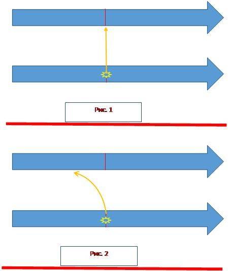

Flying two aircraft (parallel and synchronous).
From the first emitted light beam. As this beam reaches the second plane?
Perpendicular (FIG. 1), or with a bend (FIG. 2)?
  • Two diagrams of parallel blue arrows pointing right, each row marked with a light source; Fig. 1 shows a straight yellow arrow from the lower source up to the upper row, Fig. 2 shows a curved yellow arrow from the lower source bending toward the upper row.
It will arrive perpendicular from the point of view of the plane and not perpendicular from the point of view of the ground.However, the ground observer can also compute that the plane would measure the angle as perpendicular.
Figure 2 isn't quite right. The path observed from the ground is not perpendicular, but it's also not a curve - it's a slanting but straight line.

We already have answered on the basis of the way things are. The path of the light is straight according to both observers; and it is perpendicular to the flight path as viewed from the aircraft and not quite perpendicular to the flight path as viewed from the ground (although for aircraft traveling at speeds not more than a few thousands of kilometers per hour relative to the ground the deviation from exactly perpendicular will be very small).
Of course this answer is also consistent with the theory of relativity. If relativity said something different, then we'd need to discard relativity in favor of some other theory - but fortunately it doesn't.

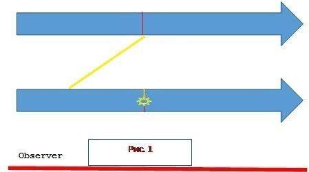

I think this is what the ground observer would see:
Diagram of two horizontal blue arrows pointing right, one above the other, with a yellow diagonal line from the lower arrow's left to the upper arrow, a green star on the lower arrow and an Observer label below; caption reads Рис. 1.
And it depends on how fast the planes move. The faster, the more slanting the light will be. I don't think this is the Relativty theory, but...
And since the speed of light is always the same, then you can calculate how long it will travel from the below plane to the upper plane.

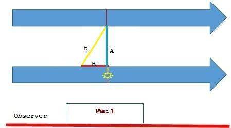

It is the hypotenuse of ##t^2 = A^2 + B^2##
Supposed the distance the plane travels is B in time unit for light to travel from below to above, slanted.
And the distance of the plane is A, in the time it takes for light to travel PERPENDICULAR from below to above.
Diagram of a light pulse in two horizontal arrow-shaped frames, one above the other, with a yellow slanted line labelled t, a blue vertical line labelled A, a red horizontal segment labelled B, and a starburst at the lower frame marking the emission point; an observer is shown below.
Suppsed the planes travel at 0.6c(V). And it takes light to travel from below to above at 5 seconds(t).
So, V=0.6c
t=5
Then, ##B = Vt = 3##
The hypotenuse will tell you that A distance is ##A = \sqrt{t^2-B^2} = 4##
It takes 4 seconds for light to travel perpendiculare from below to above. I think this is still not relativity, but...
The time it takes according to the planes clock to travel B distance is 4 seconds. I think this is the relativity thing.
As in Lorentz contraction.
I'm terribly sorry if my calculation is wrong and it misleads Bahmanyar, but I'm sure the good advisors/mentors will immediately step into correct it if it is wrong..
And if the planes travels, say 0.9999999 (seven 9's) the speed of light, then the light beam will look almost horizontal, and it takes about 8944 seconds for light to reach the plane above. But it will always take 4 second according to the planes clock for light to travel from below to above.

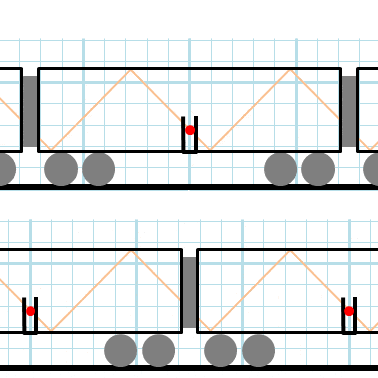

I previously posted this diagram to illustrate something bouncing between the roof and floor of a train, but the same principle applies to this thread, if we imagine the floor and ceiling to be the two aircraft.
DrGreg said:
Two-panel diagram of a train carriage moving along a track, with a zigzag orange light path bouncing between ceiling and floor and red dots marking light sources or detectors at the carriage walls.
Here's something (it could be a pulse of light, it could be a ball) bouncing up and down in a train.
An observer in the train (top) infers the thing is moving vertically up and down.
An observer on the ground (bottom) infers the thing is "sliding sideways" in a zig-zag path.
This is valid in both relativistic and Newtonian mechanics.
