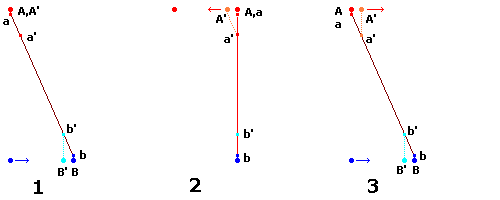

Here are three diagrams showing the relativity of motion between a light source at A and an observer at B. Fig. 1 and 2 show how aberration and doppler effect occur for two bodies moving in different reference frames. Fig. 3 shows how aberration and doppler effect could actually be occurring at the source but would later be nullified at the observer, thus would always be unobservable, for bodies moving in the same reference frame.
At fig. 1, the observer is considered moving while the source is at rest. While the observer at B travels to B', light travels from A to B', so for the observer at B', the light ray suffers the aberration angle α and has the apparent direction of the dotted red arrow, but it also suffers doppler effect because the observer is moving at an angle to the incoming ray.
At fig. 2, the source is considered moving while the observer is at rest. While the source at A travels to A', light travels from A to B, so for the observer at B, the light ray does not suffer aberration but has the same apparent direction as in fig. 1. For us, it makes the same angle α with A'B, and it does not suffer doppler effect because the ray was emitted at a normal to the motion of the source, but it suffers relativistic doppler effect, which gives exactly the same number as in fig. 1 where the observer's speed was producing doppler effect while moving at an angle to the ray.
At fig. 3, both source and observer are considered moving at the same speed and in the same direction, so the only difference with fig. 1 is that the source is also traveling. For the observer at B', the light ray still has the same apparent direction as in fig. 1 since it suffers the same aberration angle, but this time, its direction points to the actual position of the light source because it has traveled the same distance as the observer, there is no measurable doppler effect because the one produced at the source nullifies the one produced at the observer, and there is no measurable relativistic doppler effect either because the two sources travel at the same speed. Of course, it would give the same result if the observer was at A and the source at B.
To me, fig. 3 means that if the source was a laser beam aimed perpendicularly to its motion, this beam would never hit the observer, which seems to contradict the reference frame principle. Does it?

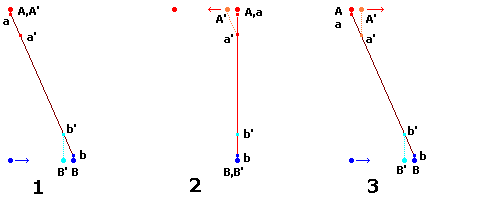

I added that to my drawings:

It seems to me that the relativity principle would prevent an observer on one of the two mirrors from being able to measure that longer echo time because the clock used to measure it would also be slowed by the motion, and in the same proportion as the echo time. So how would it be measured? Another question: for the same observer to measure a longer echo time, the light ray has to travel at an angle to the motion, in such a way that if it was a laser beam, it would have to be aimed at the future position of the mirror, which seems to contradict the reference frame principle, because by definition, a reference frame is considered at rest.
Your figure 2 is incorrect.
If A fires a light pulse( or laser) at a right angle to its relative motion with respect to B at the moment that A and B are aligned (as shown in the diagram), the pulse will miss B. In order for a light pulse fired from A to hit B, it must be fired before A and B are at right angles to each other as measured relative to there motion, and at an angle less than 90 degrees from the direction of A's motion. In other words, If we consider A as moving and B as stationary, A still has to aim its light in a way as to lead B in order to hit it, just like in the situation where we consider B moving and A stationary.
In the same vein, in the third figure, the light pulse/laser will hit B regardless of whether or not we regard A and B as moving or not. It seems to me that in both these cases you are treating light like it moves with respect to some absolute fixed reference frame, and this is not the case.
Hi again Janus. I read your article on time: very well written. You're puzzling me here though. I thought that, if the direction of a light ray had to stay independent from the motion of the source, and if that ray had to hit the target at 90 degrees, it necessarily had to be fired at 90 degrees too, thus at the vertical to the observer. What do you mean exactly? Can you develop a bit please?
Fig. 3 is a clone of the light clock, which is not supposed to need an absolute reference frame. Like the clock, it shows light traveling at an angle to hit the target, but in addition, it also shows how aberration and doppler effect would affect the beam.

Hi MT,
At fig.2, the source is considered in motion and the observer at rest, and the ray is fired at a vertical to the observer. Once light is sent, its is expected to go straight line, so if it is fired in the direction of the observer, it is expected to hit the target, no?
Mister T said:
This would be a method to distinguish between a state of rest and a state of uniform motion, violating the Principle of Relativity, something no one has yet figured out a way to do despite numerous attempts.
A good way to test the direction of light for two bodies in the same reference frame would be with using the moon as a target while the source would be traveling around the Earth at the same speed and in the same direction than the moon, but the beam would then have to stay as thin as it is when it gets out of the laser, which is unfortunately not the case. But even if the result showed that the beam is missing the target, it would not change the data from the experiments on relativity, and it seems to me that it would not change the postulates of relativity either. Fig. 3 shows that, to hit the observer, the beam should also be sent to its future position, but it also shows that aberration would change its real direction, in such a way that the observer would see the source as if it was at a vertical to him, which is exactly what moving in the same reference frame is supposed to mean. This way, and as you point out, there would be no true observable path for light either, even in the same reference frame, but then, would the light clock still be a good explanation of what is really going on with clocks in motion?
While the speed of light is independent of the motion of the source, the direction and thus the velocity will depend on the motion of the source. And when I say motion I mean relative motion. So If the source is moving relative to any particular frame call it frame 1, and fires a photon at an angle which, as measured by itself,, was at a right angle to the relative motion, then, as measured in frame 1 the photon will travel at an angle less than 90 degrees relative to the motion of the source. Look at it this way. What would happen if, in figure 1, the light is aimed at point B ( where the observer is when the light is fired) rather than B'? The light will miss the observer because he will have moved to B' in while the light arrives at B. This is exactly the same situation as fig 2, with the difference that in figure 2 we are looking at the scenario from the perspective of the observer instead of the source. The point is that you cannot get different results just by switching viewpoints. Your interpretation of how light works in these situations is mistaken.
Any aberration or Doppler effect only exists in the frame that the light clock is moving with respect to. As far as the light clock itself is concerned there is no aberration or Doppler effect. And by this, I don't mean that the aberration/Doppler effect was canceled out, but that it never existed. Again, there is no difference in figure 3 if we consider it as the viewpoint of an observer "at rest" with the light clock moving, or as the viewpoint of an observer moving past a light clock that is itself is at rest. In the second case, the observer would see an aberration and Doppler effect in the light, just like in the first case, but the light clock still wouldn't, and it would be a little silly to attribute this to the idea that somehow this was due to some cancelling out. In this, and any situation all that matters is the relative motion between the two frames, not which one we consider moving or at rest.
I thought that two observers moving in the same reference frame would experience the same time flow, that their two clocks would stay synchronized, and you seem to say the contrary. You're puzzling me again. Maybe I don't understand exactly what you mean.
Two observers at rest with respect to each other measure the same time rate. But in this instance, we are dealing with two clocks that are not at rest with respect to each other. Observer A and his light Clock at at rest with respect to the same reference frame and measure time the same as each other. Observer B and his light clock are at rest with respect to another reference frame and measure time the same. However, these two reference frames are in motion with respect to each other. Thus is A's rest frame, B is moving, and In B's rest frame, A is moving. And clocks moving with respect to each other do not measure time the same.
Raymond Potvin said:
Hi MT,
No, as explained above
Your example of the Moon and a source traveling around the Earth is a bad one. It involves circular motion, which is accelerated motion, and quite frankly, until you clear up your confusion of how light behaves under non-accelerated conditions, it is best that you stay clear of accelerated motion examples.
(For an example what I mean, if you consider things from the perspective of the source traveling around the Earth, the Laser it emits would not follow a straight line but would appear to curve.) You are also not clear by what you mean by the source and Moon moving at the same speed. Do you mean that the Moon is directly overhead at all times relative to the source, in which case, their "speed" is not the same. The Moons travels at ~1 km/s in its orbit. A source traveling around the Earth and keeping the Moon overhead would only be moviing at 17 meters/sec.
The better example is two spaceships traveling side by side with their engines shut off. Ship A fires a Laser at Ship B. You seem to be under the impression that in order for A to hit B, that A has to aim ahead of B, But because of aberration and Doppler effect, B will see the light coming directly from A. But this is a violation of the principle of Relativity and the postulates of Special Relativity. This is because A has to change his aim depending on whether We consider A and B as moving or not. If A and B are "At rest" he aims straight across, if they are "moving" he has to aim at some other angle. This implies a "preferred rest frame", the one where A can aim straight across and hit B. There is no such frame. The only thing that determines where A has to aim in order to hit B is the relative motion between A and B, and not any perceived shared motion of A and B.
Maybe you misinterpreted drawings 1 and 2, because they are symmetrical and they give exactly the same result for doppler effect and for the apparent direction of the ray, except that it is a relativistic doppler effect for fig. 2 whereas it is a direct one for fig. 1.

In fact, I am only applying aberration and doppler effect to the light clock, but I never saw this idea elsewhere, so I am uncertain that I am aloud to do that. Am I?
Certainly you are allowed to do that. Both the relativistic Doppler shift and aberration are zero for a detector at rest wrt the source.
Of course we know there is no aberration or doppler effect if there is no relative motion, but we also know that these effects manifest themselves if there is, in such a way that if a laser beam is sent between two bodies in relative motion, it will miss its target if it is not sent in the direction of the future position of the observer. When I apply this principle in fig. 3, I don't think that I refer to an absolute reference frame, I think that the only reference I use is light. Could aberration and doppler effect be an absolute reference for bodies in motion? Does that contradict the relativity principle?
The effects are symmetrical: Mount a source and a detector on each body, and both will see the same effects. So which body would be in absolute motion?
Hi A.T.,
I did not mean absolute motion wrt to another body, I meant absolute motion wrt incoming light rays, which is symmetrical and thus applies to the two bodies, as on fig. 1 and 2.
We have explained ad nauseam that if this adjustment to the direction were necessary it would be possible to use the results of the adjustment to distinguish between a state of rest and a state of uniform motion. Such a thing has been demonstrated both theoretically and experimentally to be false.
The real world is different from the world you describe.
Hi A.T.,
The term "absolute motion wrt" doesn’t make any sense. if it's "with respect to" something, then it's relative, not absolute.
Yes, that is correct.
No. I am not sure what makes you think that it would. Could you explain your reasoning in more detail for the specific case of inertial motion only?
Anything that would allow determination of an absolute reference frame would contradict the relativity principle.
@ A.T.
Maybe I should have described light as a relative instead of absolute reference, but we know its properties are absolute in all inertial reference frames, so I used absolute.
I think that I do not use fig. 3 to distinguish between rest and motion, but only to show that the properties of light would be respected if it would travel the way it does, which means that it could really travel this way without changing anything to our observations, except for the laser beam missing its target, of course. But would that contradict relativity? I don't think, but I'm not sure.
I've tried to redraw the pictures correctly.
A' is a short time after A, B' is a short time before B.
Lowercase letters show the direction of light.
In Fig.1, A has to send light at an angle, and it arrives to B vertically.
In Fig.2, A has to send light at an angle, and it arrives to B vertically.
In Fig.3, A has to send light vertically and it arrives to B vertically.
Does that answer your questions?
