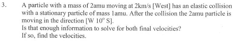

1. Homework Statement
The problem is in the picture(attached)
2. Homework Equations
I know we have to use
m1v1 + m2v2 = m1v1' + m2v2'
(1/2)m1v1^2 + (1/2)m2v2^2 = (1/2)m1v1'^2 + (1/2)m2v2'^2
3. The Attempt at a Solution
All I know is that it needs to be split up into components.
Please help me out.
  • Printed physics problem 3: a 2 amu particle moving at 2 km/s west collides elastically with a stationary 1 amu particle; the 2 amu particle then moves at 10 degrees south of west; asks if enough information exists to solve both final velocities and, if so, to find them.
Yes, the first equation is a vector equations, and needs to be split up into two scalar equations.
(You could choose West and North for the component directions, for example.)
So … show us what you get. :smile:

No, you should be able to do it in the reference frame given.
Thanks guys, and yes I will try this question out. I got some help today from a friend, he said that there was no need for NS/EW components. He told me to make a triangle. So therefore the resulting velocity after the collision of the 2amu mass would be v1'cos10.
2(2km/s) + 1(0m/s) = 2(v1'cos10) + v2'
4 - 2v1'cos10 = v2' (this will be equation one)
We know kinetic energy is conserved:
2(2km/s)2 + 1(0m/s)2 = 2(v1'cos10)2 + v2'2
8 - 2(v1'cos10)2 = v2'2 (our second equation)
Then sub in equations into each other for v2'.
I have to go for now but I will get back to you guys soon on the problem. Please keep in mind that I am only in grade 12:confused:. Thanks again.
