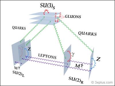

An understanding of this image might help? From, http://www.diffusion.ens.fr/vip/pageJ03.html

This is one of the easier kinds of string model to understand... There is a famous kind of illustration of extra dimensions (e.g. see bottom picture on this page) which shows a grid with a gnarly shape located at each point of the grid. The grid stands for 3+1 dimensional space-time, each gnarly shape stands for the extra dimensions at that point. You should imagine this web of branes-connected-by-strings, as the gnarly shape present at each point of the macroscopic space-time. A particle - let's say an electron - is a particular type of string (in the diagram, it would be one of the "lepton" strings), and an electron traveling through 3+1 space, is an electron-string maintaining its location in the brane-web, but moving along the grid.
There are many elegant aspects to how this works. Each brane stack carries a gauge field. Strings within the stack are the gauge bosons, strings between two stacks are charged under both gauge groups because they can interact at their ends with the gauge bosons. The strength of the gauge coupling depends on the volume of the branes. The massive Higgs comes from a gap in one of the stacks; the yukawa interaction which gives fermions mass, is a three-way interaction with the Higgs string whose strength depends on the surface area traced by the strings. The branes, and the dimensions containing them, are dynamical, and their lowest-energy configuration determines all these areas and volumes that in turn determine the parameters of the standard model.
When you look further at the details, then you get some complications. That picture is only telling you how the branes intersect and what they mean physically. The actual geometry of the brane stacks is hard to visualize - intersecting three-dimensional objects in a six-dimensional space. Also, it's actually an orbifold space, one that has been "divided by a reflection". Also, all those strings are superstrings, so that e.g. each "quark-string" actually has a quark mode and a squark mode. Worst of all, for a typical model, no-one can actually calculate the lowest-energy configuration of the brane geometry! So we can't extract the predicted values of SM parameters that should be implied by a specific choice of geometry.
