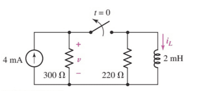

Finding the current at (a) the instant just before the switch opens (b) the instant just after the switch opens.
iL before switch open is i+(0) and iL after the switch opens is i-(0), and i(0)=i+(0)=i-(0) so both have the same value?
Is that really a relevant equation ?
Or just a wild guess.
Please post a realistic attempt at solution, so we can help (PF guidelines forbid us unless...)
It isn't exactly a related equation but I couldn't leave it empty so I put it there, i have attempted a solution on my own, but my question is just if the current at the instant before the switch opens=the current at the instant right after the switch opens. I just want to know if that's correct or not because it's relevant if I want to continue solving the rest of the question with my solution.

Okay, my professor's lecture was very confusing and didn't properly explain initial conditions, but now I used outside sources to study and my confusion about the question is cleared so I'll delete this in a bit.
You have picked up the essential part of this exercise: the inductance will behave in such a way that a change in current is counter-acted, according to the relationship $$V = L{di\over dt}$$so: bravo, well done !
