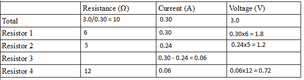

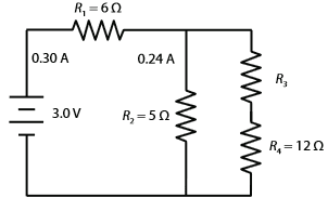

The discussion revolves around an electric circuit problem involving the determination of missing resistances, currents, and voltages, particularly focusing on resistors R3 and R4 in relation to R2.
- Exploratory, Assumption checking, Conceptual clarification
- The original poster expresses confusion regarding the calculation of R3 and questions whether R3 and R4 share the same voltage. Participants discuss the implications of resistors in parallel and the relationship between voltages across them.
Participants are actively engaging with the problem, exploring the concept of voltage in parallel circuits. Some guidance has been provided regarding the voltage across R3 and R4, with a suggestion that it may equal 1.2 V, although this is still under consideration.
The original poster has attached images for reference, which may contain critical information for solving the problem. There is an indication of uncertainty regarding the relationships between the components in the circuit.
