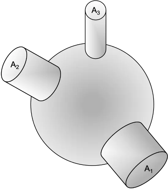

I hope this will undizzy you and perhaps get the OP on the right path.
Consider a closed, for simplicity spherical, surface and three conductors of different cross sectional areas ##A_1##, ##A_2## and ##A_3## respectively carrying current densities ##\vec J_1##, ##\vec J_2## and ##\vec J_3## as shown on the right. I have deliberately not drawn the directions of the current densities but they are assumed to be uniform and along the conductors, either "into" or "out of" the closed surface.
Start with the charge continuity equation in differential form $$\vec\nabla\cdot\vec J+\frac{\partial \rho}{\partial t}=0$$ Move the second term to the right, multiply both sides ##dV## and integrate over the volume of the sphere. $$\int_V \vec\nabla\cdot\vec J=-\frac{\partial}{\partial t}\int_V\rho dV.$$ Use the divergence theorem to convert the left-hand volume integral into a surface integral. $$\int_S \vec J\cdot \hat n~dA=-\frac{\partial}{\partial t}\int_V\rho dV.$$ Note that
  • the symbol ##\hat n## is the outward normal as specified by the divergence theorem;
  • on the surface the current density is zero except in the regions of overlap with the conductors. This allows us to write the left hand side as the sum of (in this case) three integrals;
  • the right-hand side is the time rate of change of the enclosed charge.
Thus, $$\int_{A_1} \vec J_1\cdot \hat n~dA+\int_{A_2} \vec J_2\cdot \hat n~dA+\int_{A_3} \vec J_3\cdot \hat n~dA=-\frac{\partial q_{enc.}}{\partial t}.$$ Using the definition of the ##k##th current ##I_k=\int_{A_k}\vec J_k\cdot \hat n~dA## , we have $$I_1+I_2+I_3=-\frac{\partial q_{enc.}}{\partial t}.$$ In the case of a steady-state circuit, the right-hand side is zero and the expression above says that the charge enclosed by the surface does not change. Whatever charge goes in the spherical surface must come out and nothng stays within. This is also known as Kirchhoff's current law.
So what about the direction (or sign) of the current? That's built in the dot products. The normal ##\hat n## is always outward. If the current density is in the same direction as the normal, the current is positive and positive charge carriers come out of the closed surface. If the current density is opposite to the normal, the current is negative and positive charge carriers go into the closed surface. Also note that this convention is consistent with charge conservation. If the left hand side is positive, i.e. net charge flows out of the surface, the rate of change ##~\dfrac{\partial q_{enc.}}{\partial t}~## of the enclosed charge is negative which means that the net charge crossing the surface must come from within. The opposite will be true if the left hand side is negative.
