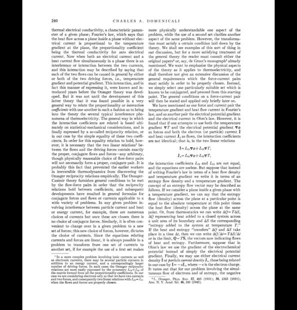

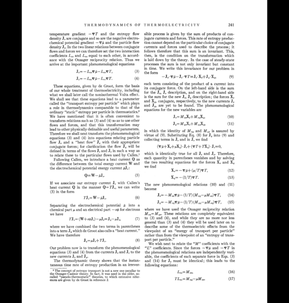

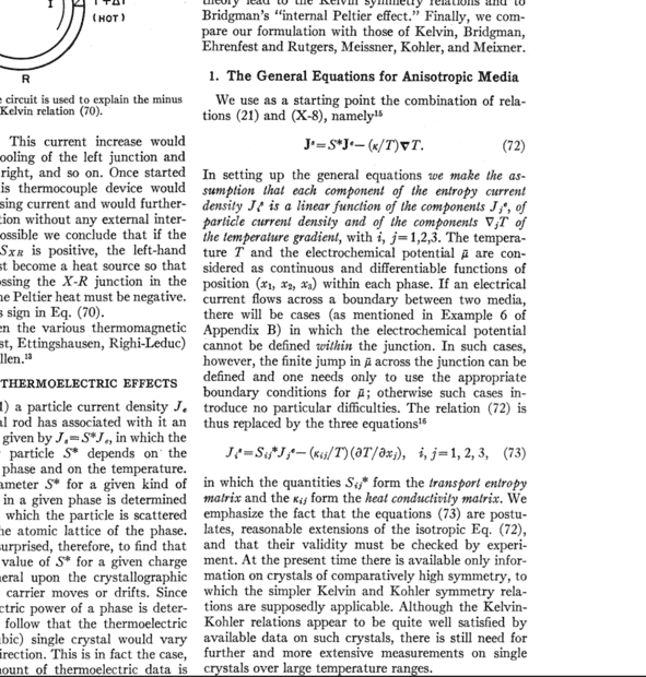

1) In my particular case, a resistive wire through which a uniform current is passing due to a gradient in the electrochemical potential (or simply a non zero voltage along it).
2) Because that's a correct expression to use in "bulk" materials, where this law holds. It doesn't hold as is for example in microscopic/mesoscopic system where a ballistic heat transport takes place, for example. Or when thermoelectricity isn't neglected. The law transforms as ##\vec{J_Q}=-\kappa \nabla T + ST\vec{J_e}##, in other words, the heat flux at every point in the material is the sum of the standard Fourier's conduction term plus the Peltier heat (when the Peltier heat changes along the material, heat is released or absorbed, causing what people call the Peltier effect. However Peltier heat is present everywhere in the material, and not just at junctions of different materials, but let's not open this can of worm. Thermoelectricity needs a modern rewrite of a textbook that doesn't follow historical discoveries. That field is plagued with misconceptions due to this.)
The radiation only occurs at the surface of the material. In my case, if I wanted not to neglect it, then I should include it as a boundary condition. This only complicates the problem, in my opinion. The problem I solved (heat equation of the wire), assumes the wire's surface is kept at a fixed temperature, so it's valid if I had say a PID (and possibly equivalent to any steady state problems, too, including with radiative effects since the temperature will end up being uniform on the surface of the wire, and time independent in all cases).
3) If you do that, you end up with "Joule heat equals 0", or said differently "The electric current vanishes". There is no thermal gradient anymore, the problem is completely uninteresting, there is nothing to study in that case.
I have found another justification of TJs=Jq, and where both eqs. 2-38 and 2-39 appear. The reference is nothing less than Callen's Thermodynamics textbook, chapter 14.

coquelicot said:
Well, the internal energy U in thermodynamics is defined up to a constant, because it is impossible to know all the energy forms. But let forget that and say that you are right: the internal energy is well defined in thermodynamics.
On the other hand, I have googled hours and haven't found something like this ##\vec {J_U}##. Even the thesis of Craig you provided defines everything rigorously in (2-13), but not a general "internal energy flux". I can conceive you have top books that go further, so could you provide a source to where someone else has used ##J_U## just like that?
Of course, but heat equation in a wire is not the problem here. The problem for me is your "free" use of fluxes. I am waiting for your references, if possible, hoping my eyes will be opened.
Well, maybe start with the Callen ref. I posted earlier (he uses ##\vec W## while I use the notation ##\vec{J_U}##), or the one I posted around 1 hour before your post. Google gives me a djvu version of his Thermodynamics textbook (maybe the 4th or 5th google result), I said to check chapter 14.
Or eq. 72 of Domenicali's "Irreversible thermodynamics of thermoelectricity". Or page 241 of that same article, where it is written
Domenicali said:
Following Callen, we introduce a heat current ##\vec Q## as the difference between the total energy current ##\vec W## and the electrochemical potential energy current ##\overline{\mu}\vec{J_e}## : ##\vec Q = \vec W - \overline{\mu}\vec J_e##. If we associate our entropy current ##\vec{J_s}## with Callen's heat current ##\vec Q## in the manner ##\vec Q=T\vec{J_s}## (...)
. Or the page just before that (240), he fully justifies in words and arguments that ##\vec Q =T\vec S##, please read that part if you really want to dig this up.
Assuming you refer to Callen Chap 14 eq. 14.33 and 14.34: there is absolutely no derivation for this formula, and even not a hint about what "energy" he speaks about. This formula is simply parachuted here. Not to speak about (14.33) he says "can be derived like..." which is not obvious at all. If you refer to another section or equation of this chapter, please let me know.
Again and again and again, I have no problem with heat and entropy fluxes, nor with heat equations. These are well defined notions. I have a problem with your alleged "internal energy flux" which "takes into account all possible forms of energies". I don't see that it is defined, and it is even not obvious that the "local energy flux" of Callen is the same as your energy flux.
I don't have access to the article of Domenicali, so, if you can post a snapshot of p 72 to show how he defines your "internal energy flux" (unless that's not that but licit heat equations, involving entropy and heat fluxes, whose I have no problem, again and again and again).

  • #142
I can do no better than providing the full article, if there is something that should open your eyes, it has to be found there.
It is not "my" internal energy flux, as I said, there is nothing new in what I've done.
Regarding the Callen's objection, I do not see the "can be derived like..." part. Regardless of this, I am now seriously trying to understand what is troubling you. If you say you have no problem regarding the derivation of the heat equation(s), then you have an idea about what ##u## the energy is, right? Callen's nomenclature is fully defined, as far as I know. He also uses and define ##\vec {J_U}## by the way.
Just to be clear, you have a hard time to swallow eqs. 14.33 and 14.34 from Callen's textbook?
Edit: Too bad, the article is too big (>3MB). It's worth checking out though.

  • #144
If the article is in pdf form, almost every pdf reader contain an option named "snapshot", that allows you to take a snapshot of a page (or a part of a page) and to save it as a picture.
Yes whenever ##u## is the heat, a well defined form of energy, and whenever its flux is defined via the Fourier relation with the temperature.
But as I said, I also accept the internal energy of a system as a truth. So, no problem with ##u## again. I have some problem with the flux of ##u##, because in order to define a flux, you need to have a flow (that's the words of Callen), that is, a field of velocities. Now, I don't see how a flow could be associated a priori to the internal energy of a system. I repeat again what I said above: I can accept your relation as a definition of the flux of ##U##, where ##U## is some energy. But we have to understand what this energy is: you cannot claim a priori (in my opinion that could change) that that's the internal energy of the system. The problem is a problem of interpretation. You have essentially set a definition of ##\vec J_U##, but you may be "lying" about what is this ##\vec J_U##.
Actually yes. I have not read the whole book, only Chap. 14, so, he may refer (without reference) to some other parts of the book. But as I see it, rel. 14:33 is just parachuted here. I see no justification for this formula at this place.

  • #146
coquelicot said:
If the article is in pdf form, almost every pdf reader contain an option named "snapshot", that allows you to take a snapshot of a page (or a part of a page) and to save it as a picture.Yes whenever ##u## is the heat, a well defined form of energy, and whenever its flux is defined via the Fourier relation with the temperature.
But as I said, I also accept the internal energy of a system as a truth. So, no problem with ##u## again. I have some problem with the flux of ##u##, because in order to define a flux, you need to have a flow (that's the words of Callen), that is, a field of velocities. Now, I don't see how a flow could be associated a priori to the internal energy of a system. I repeat again what I said above: I can accept your relation as a definition of the flux of ##U##, where ##U## is some energy. But we have to understand what this energy is: you cannot claim a priori (in my opinion that could change) that that's the internal energy of the system. The problem is a problem of interpretation. You have essentially set a definition of ##\vec J_U##, but you may be "lying" about what is this ##\vec J_U##.Actually yes. I have not read the whole book, only Chap. 14, so, he may refer (without reference) to some other parts of the book. But as I see it, rel. 14:33 is just parachuted here. I see no justification for this formula at this place.
Ok, my PDF reader (zathura) doesn't have this option, I believe. I took 3 screenshots.
Right, it is possible to assign an energy density and a velocity to the energy flux.
Let's consider a simpler case, a wire with a thermal gradient along its length, say. (no electric current). In that case, the energy flux is equal to the thermal flux, in my notation ##\vec{J_U}=\vec{J_Q}=-\kappa \nabla T##. In that particular case, we can assign a heat density ##q## and a velocity ##\vec{v_\text{heat}}## such that their product yields the heat flux ##\vec{J_Q}##. In this case the velocity is probably the speed of sound (phonons, even though the electrons also carry heat and make up for a good portion of ##\kappa##, but they scatter too much to transmit heat faster than sound, I think).
Back to our example, we have exactly the same thing, but the addition of a term coming from the particle's motion along the wire. The total energy flux will therefore have several contributors, and won't be pinpointed to phonons/electrons alone, but also with whatever particle is flowing along the wire.
Since the direction of ##\vec{J_U}## changes along the wire, so does the velocity of every (quasi)particles that makes up for it. At least, that's how I see it.
You have probably saved the pictures in lossy compression mode, they are blured and almost not readable. What a pity! as the few I have been able to grasp from this article seems to be exactly the answers to my questions.
  • #149
I could save the pages individually as PDFs. Attached docs.
