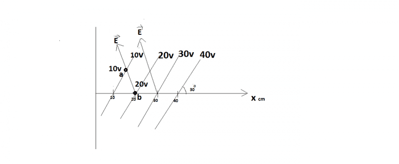

I know electric field points in direction in which the potential is decreasing.
How does potential decrease in that direction?
Here is what I think
potential at point a is 10v and at point b it is 20v
and direction of E points from b to a,hence
Am I thinking right?

Not quite. Imagine a particle of negligible mass and positive charge located at Point b. Release it and it wouldn't move towards Point a. It would instead move towards the 10-volt line along a path of shorter distance. The electric field ##\vec{E}## is tangent to that path at each point.

Yes.That's what I have drawn.

But it doesn't look like that. If your diagram is simply 2D, your field lines are at about 60 degrees to the equipotentials. Were you attempting to show a 3D view in perspective?
yes,sort of.
gracy said:
yes,sort of.
Then show all the three axes, x, y, z, and equipotential surfaces instead of lines.
Actually ,I don't know .In my book it was an example ("solved problem)and it has been drawn in the same manner as I posted.I wanted to know the reason.

Well, we can imagine that the equipotential surfaces are planes and the drawing shows the projections on the (xy) plane, so the surfaces are vertical (out of the page). There are no a, b points and E vector. You see distances along the x axis. You see the angle, that the lines enclose with the x axis. And you see the potential value along the equipotentials.

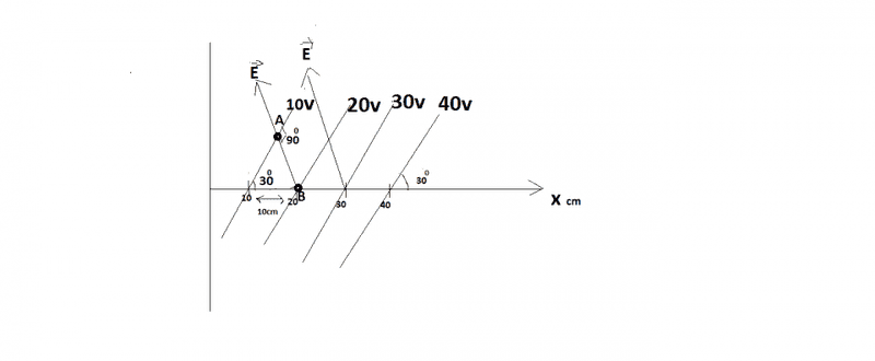

Question:some equipotential surfaces are shown in the figure below What can you say about the magnitude and the direction of the electric field?http://postimg.org/image/k6cm9b9wf/
solution:First,we will find the direction of the vector ##E## note that Electric field lines are always perpendicular to the local equipotential surfaces.Electric field points in direction in which the potential is decreasing .So,it will be as shown below
http://postimg.org/image/akdl027z3/
Note that we have drawn the Vector ##E## lines perpendicular to all equipotential surfaces and it is pointing in that direction in which the potential is decreasing.So,the total angle vector ##E## is making with the positive x-axis is 120 degrees as shown.
Now,how to calculate the magnitude of the electric field!For this we need to jump from one equipotential surface to another through shortest (perpendicular )distance.
Then calculate ,##E##=##\frac{change in potential}{distance traveled}##
Let us suppose we are jumping from 20V line to 10V line from ##B## to ##A##.Note that the ##BA## line is the shortest length between the two equipotential surfaces.The potential difference between the two lines is (20V-10V)=10Volt.Now,calculate the length##AB##=##10Sin30##cm=##5##cm=##5##×##10^-2## m
Therefore ,##E##=##\frac{10V}{5×10^-2}##=##20##[V/m]
Hence ,the complete answer is that the vector ##E## has the value 200V/m and makes 120 degree angle with positive x-axis.
