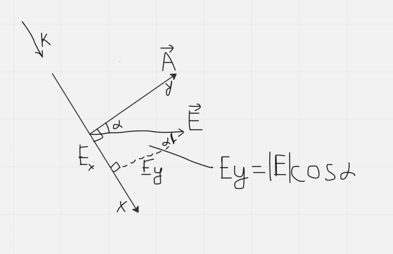

I have been thinking today about electric flux and it got me (as always) into confusion. I love to dig deeper and sometimes, I deviate from the truth.
Let's consider the tilted surface where Electric field is passing by. I'm attaching the image as well. I know that to calculate flux, we must do `EAcosa` (for simplicity, E is uniform, so no integral needed)
As we know, any vector(V) in x-y plane has two components. (Vx, Vy). On x-y plane, it seems easy to even see this in drawing.
Since electric field is also a vector, it will have Ex, Ey as far as I can see(let's forget Ez for now). On the image(I drew it), you can see `Ex` and `Ey` components of E vector. They are x and y components of E because our x-y plane is a little bit different(to see it better, you have to rotate your head :rolleyes:)
Now, the funny thing is in the calculation of flux, Ex is not included, only Ey and we get AEcosa(true that `a` is angle between E and A, but from my image, we use the 2nd angle which is the same). I'm wondering why Ex is not included. Here is my reasoning. Well I understand that Ex component goes into the `x` direction, but it still has magnitude(non-zero) and why are we saying that it's not contributing to the flux ? For sure, it's not contributing to the Ey direction, but we not only have Ey, but Ex too. It seems to me that we're only curious about the electric field strength pointed to y direction only.
If you say that we want to maximize flux, I won't agree with you since we're not maximizing anything, but rather our flux will be less by using cosa. I've searched the internet, but couldn't find what I was looking for. Maybe simple discussion would do it for me.
Maybe, I'm wrong but maybe if you look at the picture again, we can imagine that Ex has the same direction as if we would imagine electric field lines pointed in the `k` direction and if we imagine `k` field line, it just hits the surface from outward and none of it(even one bit of it) "pass" through the surface, hence we don't include it.
Is everything I said correct ?

Your area vector is in the ##y## direction (if I understand your drawing correctly). So the component of the electric field in the ##x## does not provide any flux. Only the component of the electric field in the ##y## direction. It isn't a lack of curiosity about the ##x## direction, just that component provides no flux through the area.

Yes, you're right. I have questions to confirm my understanding Dale, so all you have to do is tell me which statement below is incorrect.
1. Are my Ex and Ey components drawn correctly ?
2. Am I right that x-y plane for us to see better, we need to rotate our head to right. I'm asking this strange question because in school, we're all used to seeing x-y plane as we look at the image, but here, it's rotated. I'm asking this because I did the whole image, components by myself and wondering if the idea of what I'm saying is correct.
2. we can imagine that Ex has the same direction as if we would imagine electric field lines pointed in the `k` direction(see image) and if we imagine `k` field line, it just hits the surface and doesn't "pass" through it(even one bit of it) , hence we don't include Ex due to this reason.
You have ##~~d\Phi_E=\mathbf{E}\cdot\mathbf{\hat n}~dA##.
According to your coordinate system, ##~~\mathbf{\hat n}=\mathbf{\hat y}.##
So ##~~d\Phi_E=\mathbf{E}\cdot\mathbf{\hat y}~dA=E_y~dA.##
Nuff said.
They seem fine to me.
If you would like to rotate your head then you certainly can. But I wouldn’t say that you “need to” do it.
Yes, exactly

Let's just do the calculation with clear definitions. Let the plane given by
$$\vec{x}(\lambda_1,\lambda_2)=\vec{x}_0+\lambda_1 \vec{e}_1 + \lambda_2 \vec{e}_2,$$
where for simplicity we can choose ##\vec{e}_1## and ##\vec{e}_2## being arbitrary orthogonal unit vectors parallel to the surface. Then the surface-element vector is
$$\mathrm{d}^2 \vec{f}=\mathrm{d} \lambda_1 \mathrm{d} \lambda_2 \frac{\partial \vec{x}}{\partial \lambda_1} \times \frac{\partial \vec{x}}{\partial \lambda_2}= \mathrm{d} \lambda_1 \mathrm{d} \lambda_2 \vec{e}_1 \times \vec{e}_2=\mathrm{d} \lambda_1 \mathrm{d} \lambda_2 \vec{n}$$
and the electric flux is
$$\Phi_{E}=\int_{a_1}^{a_2} \mathrm{d} \lambda_1 \int_{b_1}^{b_2} \mathrm{d} \lambda_2 \vec{n} \cdot \vec{E}[\vec{x}(\lambda_1,\lambda_2)].$$
Clearly defining the surface with some parametrization and then just calculating the surface-normal elements is much simpler than guessing (except in very simple geometrical situations).
