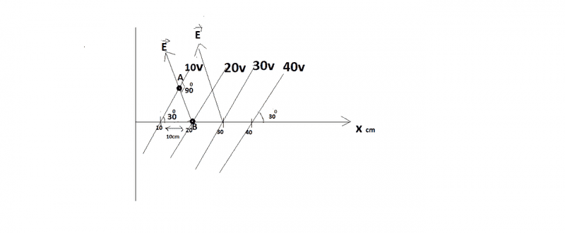

gracy said:
Here is what I think
potential at point a is 10v and at point b it is 20v
and direction of E points from b to a,hence
electric field points in direction in which the potential is decreasing.
what is wrong in it?

Mister T said:
If there's an error I
Error,Did you find any?
  • #42
Yes. In the figure you posted the electric field lines are not perpendicular to the equipotential lines. If instead it was the author's intention to show a 3-D perspective of field lines perpendicular to an equipotential surface then the lines he drew to represent that surface should all be at the same potential. Either way, it appears he screwed it up. I would need to read the book to be sure.

  • #45
Yeah, but in the original figure they show the right angles with markers. They were missing in the OP.
Of course, these angles are not really 90 degrees as drawn but they are shown to be so. A distorted figure is not really an error.:)

  • #49
gracy said:
Question:some equipotential surfaces are shown in the figure below What can you say about the magnitude and the direction of the electric field?http://postimg.org/image/k6cm9b9wf/
solution:First,we will find the direction of the vector ##E## note that Electric field lines are always perpendicular to the local equipotential surfaces.Electric field points in direction in which the potential is decreasing .So,it will be as shown below
http://postimg.org/image/akdl027z3/
Note that we have drawn the Vector ##E## lines perpendicular to all equipotential surfaces and it is pointing in that direction in which the potential is decreasing.So,the total angle vector ##E## is making with the positive x-axis is 120 degrees as shown.
Now,how to calculate the magnitude of the electric field!For this we need to jump from one equipotential surface to another through shortest (perpendicular )distance.
Gracy, these are not the original pictures. You changed them. I would like to see the photos.
The lines you labelled as E and drew arrows to them are not the E lines. The E lines make 90°angles with the equipotentials. Do you know how 90°angles look like?

I find one thing fishy here.
Where did that 10 cm come from?It is not given and there is no explanation about this in solution.

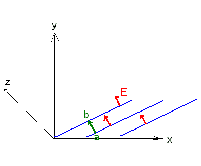

A distorted figure is confusing. I think, the figure shows the projections of the equipotential planes onto the (x,y) plane. These planes are parallel with the z axis, which is perpendicular to the page.
The electric field vectors are parallel with the (x,y) plane and perpendicular to the blue equipotential lines. The equipotentials are at 30°angle with the x axis, the E vectors make 90°angle with the equipotentials, so the E vectors are at 120°angles with the x axis.
The green line connecting points a and b represents the displacement in the direction of the electric field, from one equipotential to the next. Its length is the distance between the equipotential surfaces. The magnitude of the electric field is potential difference divided by the distance between the equipotentials.
  • #53
You see the marks on the x axis: They are 10 cm apart, where the equipotentials intersect the x axis.

One more thing.How can one vector (linear )be parallel to a plane?
  • #58
If the straight line does not intersect a plane then it is parallel with it.
