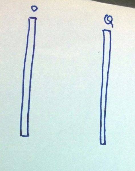

In many books, its given that if a charged infinite plate is kept in parralel with another infinite uncharged plate like this:

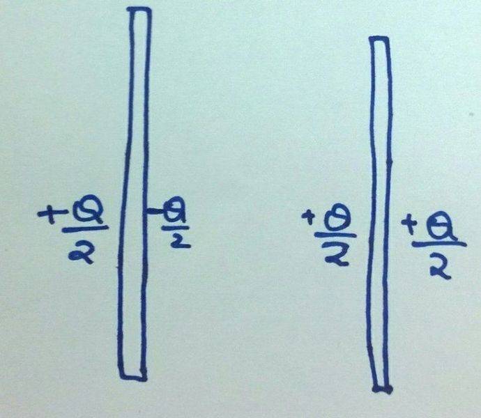

the charge distribution will be like this:
But you said there will be charges at the border as well.
Also, I have a doubt about the charge induced. Will total induced charge on one uncharged surface by another charged surface always have equal magnitude and opposite sign?

But do you realize that this is a totally different configuration with respect the one you posted at the beginning? There you had *a single charged object of small dimensions* over a metal plate; here instead you have an infinite metal plate in front of another...
The charge distribution you have wrote in your drawing seems correct to me: in the region between the two metal plates the are no charges so the total flux of the electric field exiting a volume of space put there must be zero, that is if a certain amount of flux enter such a volume through one of its surfaces, the same amount of flux must exit by another. If you take a volume with a shape of a rectangular box, with two faces touching the two metal plates, you understand that the charge density in the plate at the left must be equal and opposite to the one in the plate at right (so that the flux of E entering the box at right equals the flux of E exiting at left).
