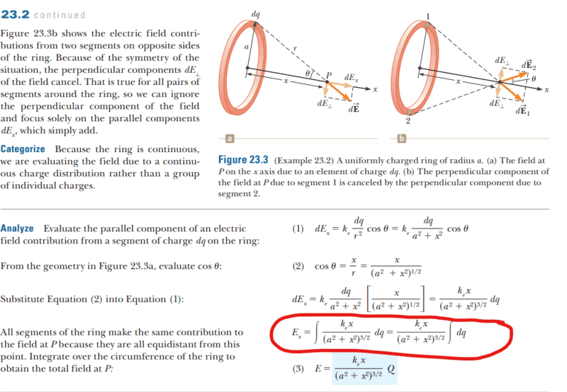

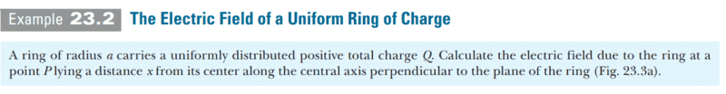

A ring of radius a carries a uniformly distributed positive total charge Q. Calculate the electric field due to the ring at a
point P lying a distance x from its center along the central axis perpendicular to the plane of the ring (Fig. 23.3a).
continuous charge distribution formula
Hi!
For this problem,
The solution is,

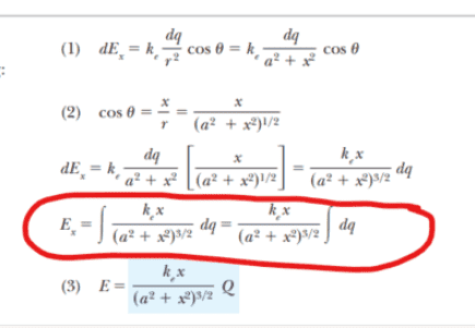

However, why did they not include constants of integration in their working shown in red?
Many thanks!

No constants of integration are called for in this case. The integral ##\int dq## is shorthand for "Add all the infinitesimally small elements ##dq## into which total charge ##Q## has been divided."
What do you get when you do that?
What else? The total charge on the ring ##Q##.

Thanks for your reply! I see what you are getting at now. All the small charge elements dq across the ring add up to Q.
However, why do they not have the limits of integration. I think they don't because the already know that the sum of charge elements dq across the ring was equal to Q.

My personal preference is not to use constants of integration in physics problems and use instead upper and lower limits of integration. Consider, for example, the simple question of finding the velocity as a function of time for an object that moves under constant acceleration. One has to integrate both sides of the equation ##dv=a~dt ## where ##a## is constant. One might write the mathematically correct expression that is taught in intro calculus in terms of a constant of integration,$$v=at+C.$$ Because the equation involves physical entities associated with the physical motion of an object, I view the integration as adding up infinitesimal elements of velocity on the LHS and acceleration times elements of time on the RHS. As with any addition, you have to start and end somewhere and that's where the limits of integration come in. I start the addition when the clock timing the motion reads ##t_0##, at which time the velocity is ##v_0##, and stop adding when the clock reds ##t## and the velocity is ##v##. This is addition is written symbolically as $$ \int_{v_0}^{v}dv=a\int_{t_0}^{t}dt$$ from which $$v-v_0 = a(t-t_0). $$ With ##t_0=0##, which is usually the case, and after some rearrangement one gets the familiar equation $$v=v_0+at.$$ The integration constant aficionados will correctly tell you that this is the same as setting the integration constant ##C=v_0##. I prefer using definite integrals because it reminds me that integration is nothing but addition and because any needed integration constant is taken into account automatically.

Thanks for your reply! I am very sorry kuruman, I used the wrong terminology for the integrals. I was actually asking why they don't have limits of integration. I think they don't because they already know that the sum of charge elements dq across the ring was equal to Q. Many thanks!
This is a path integral where the path is a closed curve. If you integrate the path element you get the length of the curve. With no extra constant. So, with a linear charge density ##\lambda##, you can write ##dq=\lambda ds## and the integral of ##dq## will be actually ##\lambda \int{ds}## where ##\int{ds}## is the length of the path, in this case, the full circle. You can skip all this if you realize that the integral of dq is just the total charge.

Apparently, this is a 'contour integral':
So the start point is equal to the end point, so it has no limits? But if the start point is equal to the end point then could we not just have the limits to be anything as long as they are the same? For example, could we have upper and lower limits to be Q, however, by the second fundamental theorem of calculus, they cancel!?
I guess if you have the same limits then the area under the curve is zero.
