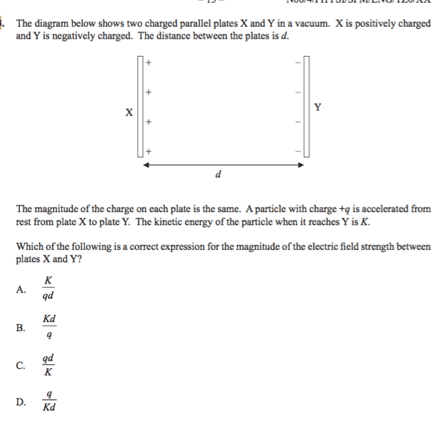

E=kq/d2
how do I involve the kinetic energy K in the equation?

What is the relationship between potential difference between the plates and electric field between the plates ?
How do you relate potential difference and electric potential energy ?
Think in terms of conservation of energy .

Electric potential energy = qV= kqQ/d
Is this equal to the kinetic energy K?

No , this is for a point charge .

Sorry, that's the only formula I know. Can you please tell me? Thank you!
If the electric field between the charged plates is E , what will be the force on the charged partice +q ?

F=Eq
Now if charged particle moves from positive plate to negative , how much is the work done on the particle by the electric force ?

W=Eqd
Now what does Work Kinetic Energy theorem say ?

work done equals to change in KE
so Eqd=K
E=K/qd

Yes :smile:
