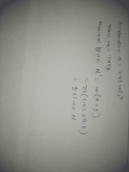

A 74.0 kg person is standing inside an elevator. The elevator is moving from the 3rd floor to the 21st floor. As the elevator passes the 4th floor it is moving at 2.30 m/s and is increasing speed at a rate of 1.43 m/s2 . At this moment, what is the normal force that acts on the person?
normal Force, N = m(a+g)
F = ma
The attempt at solution is on the attached image. Am I working it correct or should I have used F=ma?

Remember that the F in F=ma denotes the vector sum of all external forces. There are two external forces on the person.
I believe your answer is correct. The formula N = m(a+g) looks like something pulled out of thin air. If you want to show that you understand the physics, start with Fnet = ma. :oldsmile:

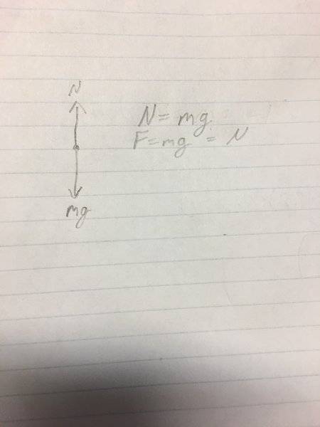

N=mg

Your diagram of the forces looks good. But there is no reason why the two forces should equal one another. The net force is the combination of the two forces. How would you combine the normal force N (which is upward) with the gravitational force mg (which is downward) to get an expression for the total force Fnet?
Fnet=N-mg
Fnet=ma
combining the two, ma=N-mg
then, N=ma + mg
N=(74)(1.43) + (74)(9.8)
N=831.02
Yes, good. Include units.
so the correct answer would be a 831.02 N normal force acting on the person?
Yes. Do you have the correct number of significant figures in you answer?
